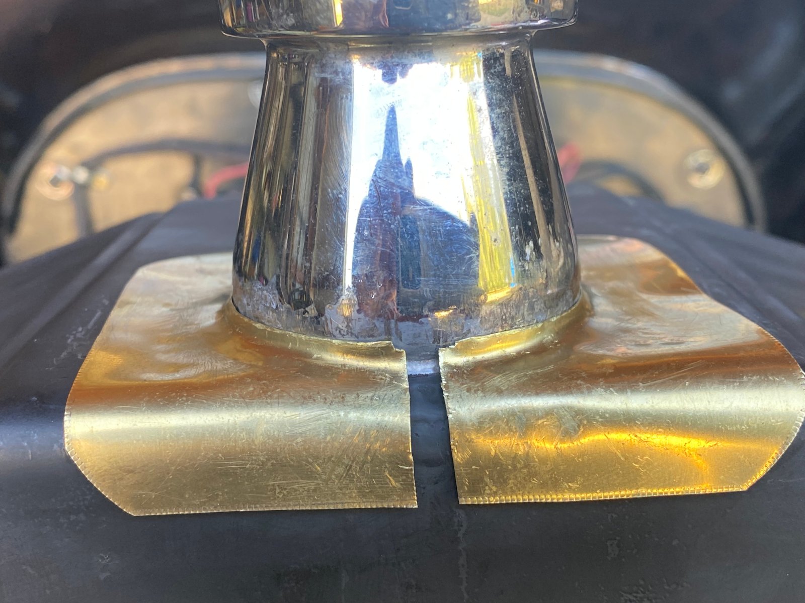

I had this idea (pictured) of soldering a piece of brass with a flange to the top of the tank and the circumference of the neck. I'm not convinced it would lend that much support but may try it.

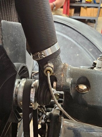

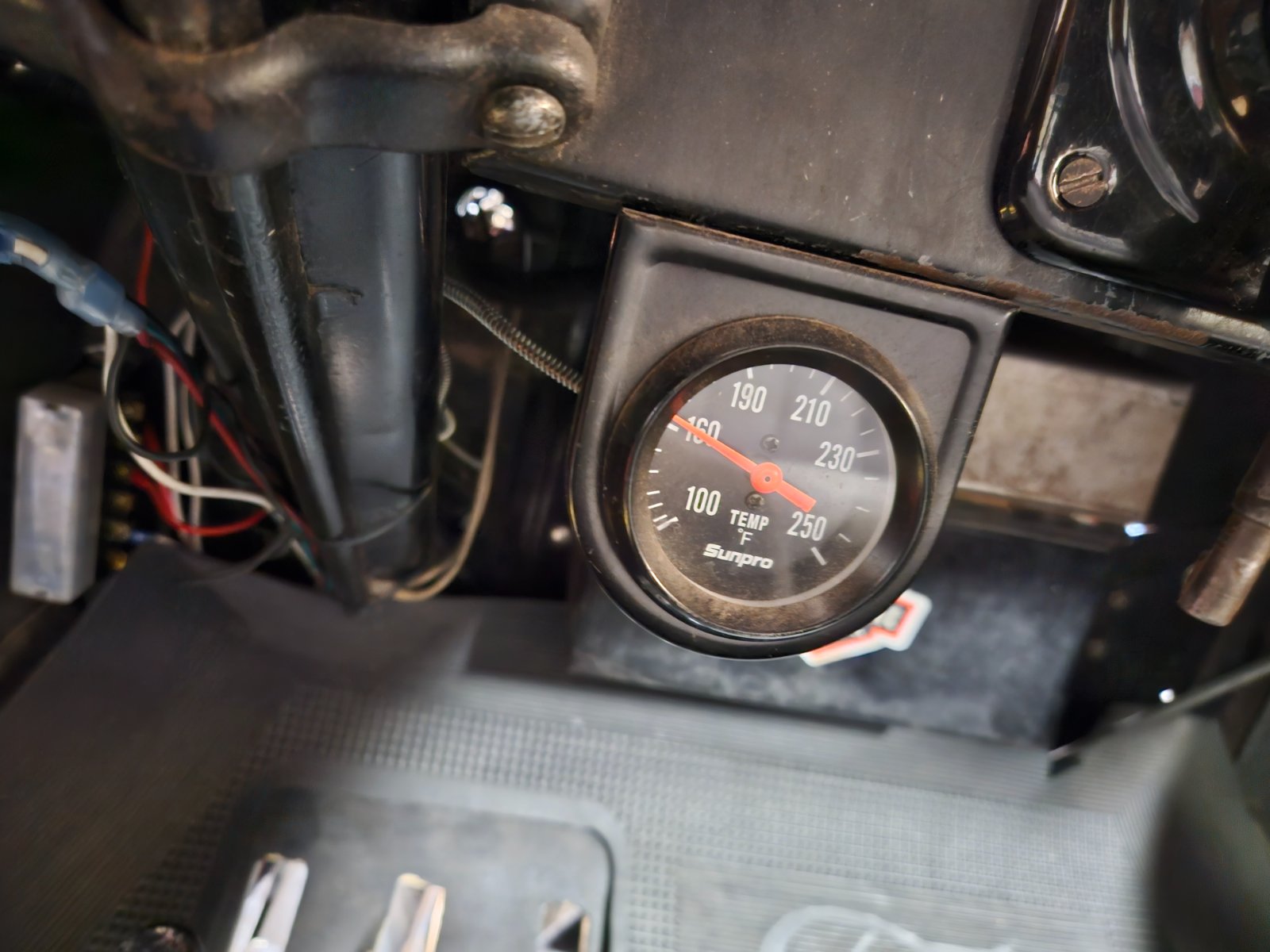

I had a wings mount cap too and the neck came loose ( not a Bergs radiator). I then replaced the wings with a plain chrome cap mount for the Moto Meter. I recently had a radiator shop reattach the neck.
BUT, this is now what I use on both my Ts. I don't have to worry about weight or if the Moto Meter is in view of the driver.

kirkiep , that looks not good ... but great . How did you get that upper connection done ? Im glad that this topic is here . I wasnt really paying attention to that rad neck. But is something to thing about when considering the $ 1000.00 cost. tx

Re: Berg's Radiator neck
Marc

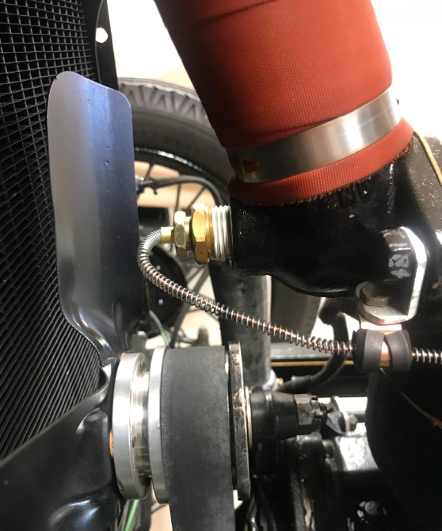

I drilled and tapped the outlet for the brass fitting. Some of the temp gauges come with 2 different size mounting fittings. I found a temp gage at O'Reillys with a black capillary tube which is not as noticeable for my other T.
I installed a temperature gauge in the water outlet on my speedster very similar to how Kirk did his. I had an old aftermarket water pump housing similar to a Nims pump. It was missing the shaft and impeller so I tapped the hole and installed the temperature bulb. Seems to work well.
