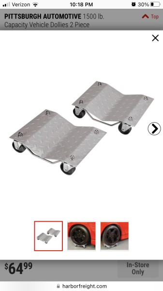

The spring is in compression, just when the pan is off you’ll be able to release tension by backing out the set screws on the clutch arms. If the driven Plate assembly is in good condition there will be no need to remove the spring. It’s not that tough a spring to remove if needed. Then remove the bolts holding the driven plate assembly to the brake drum. It will slide off. You’ll be able to remove the clutch discs with a magnet to get them up and out. A good strong magnet though because they’re in place with sticky oil. You then will find the hardest part of the job. Removing the clutch hub. This requires a specific puller and removal of the set bolt. The bolt will be wired in place as well. After that disassembly is easy peasy. Also I pictured some useful wheel dollies harbor freight sells. I use them a lot because my car is currently immobilized.
