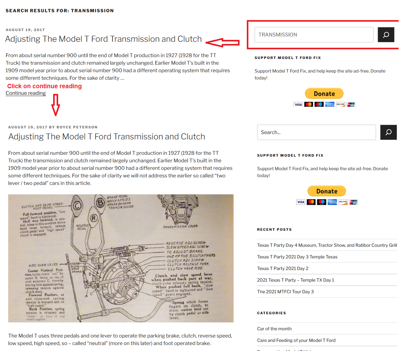

Re: Low pedal sticks to floor

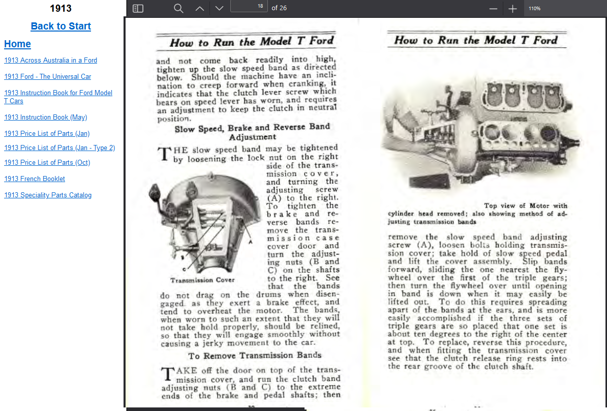

Besides Hard Copy & CD manuals there are also many available on-line for free. So if you don't have the hard copy....
For example his link is for the 1913 service manual that can be downloaded (printing as well if you have lots of paper)
CLICK ON THE IMAGES BELOW TO ENLARGE THEM
http://www.cimorelli.com/mtdl/1913/default.htm
So here is what they have on Band adjustment also the index to other manuals for the 1913 that are available --
Numerous documents are available, Owners Manual, Service Manuals & Bulletins, Parts Listings etc etc. Indexed by year or Title - -

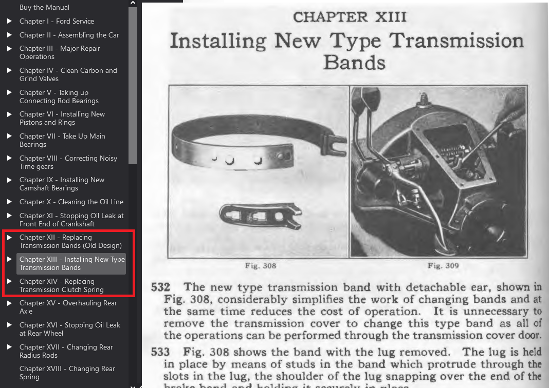

This is a complete 1915 Service Manual all 296 pages
This is the link to it (too large to add here as an attachment) http://www.cimorelli.com/mtdl/servicemanual/default.htm
Looks like this --
Another good reference is https://modeltfordfix.com/adjusting-the ... nd-clutch/
Looks like this --
