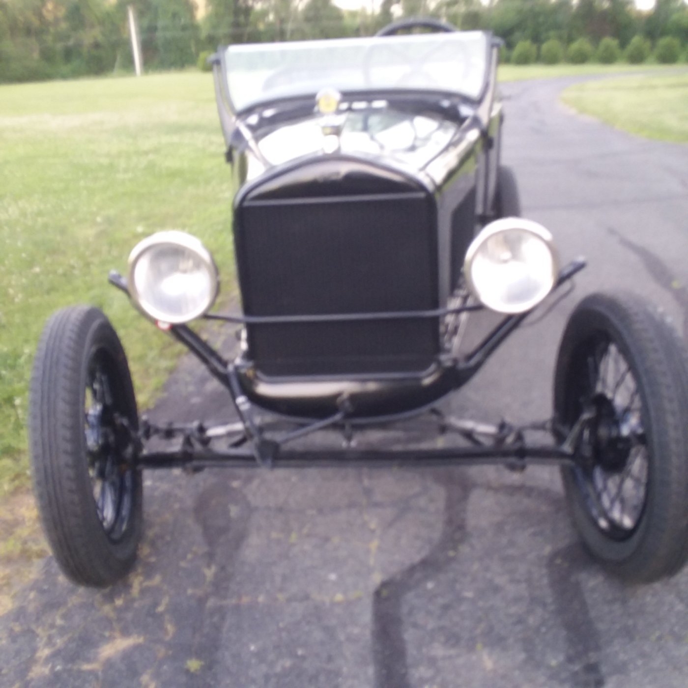

I brought my '26
Lower windshield to my glass guy. He removed the glass for me. I then took the frame home and cleaned it up, and painted it. I brought it back to him and I got a nice safety glass install for $175. I let the pro deal with the hazardous 97 yr old glass and I'm glad I did.

Professor Fate wrote: ↑Fri Nov 10, 2023 7:48 pmI brought my '26
[/size
20220610_201106.jpg0 y]
I would (and will) do the same.
