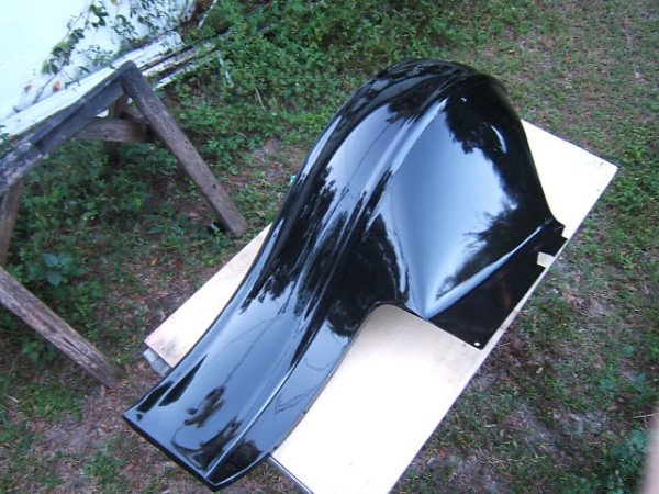

This fender was painted 13 years ago with Rustoleum High Gloss Appliance Epoxy. This is one coat. There was no need for a second coat. I used one can and a little bit of a second can I had ready and sprayed, continuing to spray over areas of overspray until the entire fender was wet. As Wyatt Earp said in an interview in which he was asked “what makes a successful gunfighter?” “You take your time in a hurry.” That is the approach to this type of painting. Go fast enough with several passes to get the paint thick enough to have a nice smooth uniform finish without runs and don’t try to do too big an area at one time. This fender is about the maximum size to achieve this type of result. Better to keep the area smaller, rather than larger. If you try to do too much, the overspray will start to cure before you can get back with another pass to re-wet and build up the coat.
The only people, with Appliance Epoxy is it comes in only 3 colors. Black, White and Almond, but Rustoleum has a wide variety of colors in their other types of paints.
If you are on a limited budget, you can do the car in manageable increments such as one fender ant a time, the hood, one door ant a time, etc., and get a very nice result. Jim Patrick

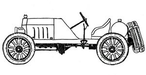

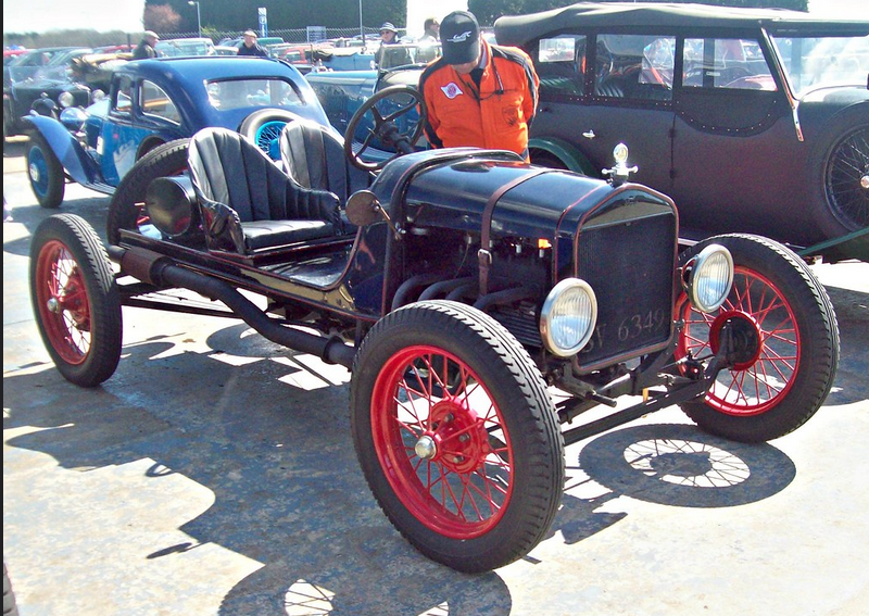

I just started taking off the old red that the speedster was painted. Well, it was red with white from the frame and on down. The steering column was brass under the red. After working on it today I am now certain I want the whole thing dark blue, other than everything under the hood.
This doodle I did is what I am hoping to end up with. My friend has a hot rod shop and is an insane metal bender.
Wee Speedster Pen.jpg (35.03 KiB) Viewed 2046 times
