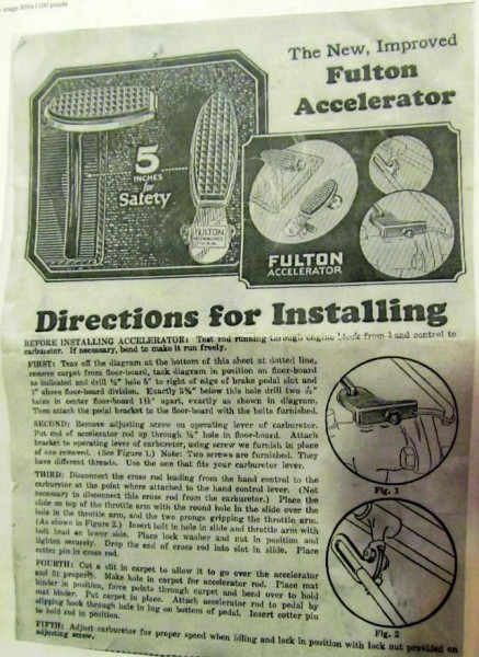

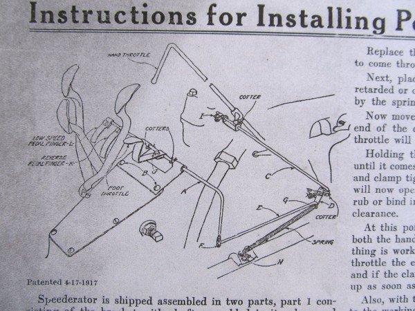

There were accessory kits available from the suppliers years back, besides back when.

More ideas

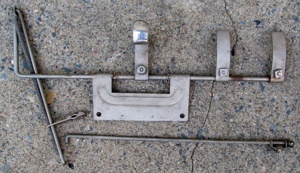

Texas T Parts used to sell one that works well. I bought one before Bird Haven bought them out and it disappeared. It would be easy to duplicate.
TTP Foot Throttle.pdf
(151.13 KiB) Downloaded 144 times
Thanks for the pictures & instructions. I have one that I was thinking of using, now its a no brainier.

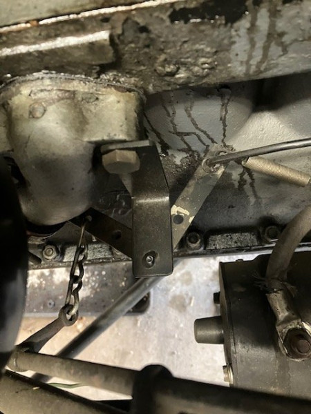

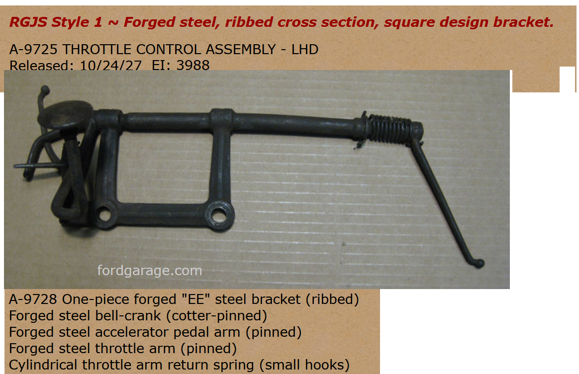

I found this for a Winfield down draft carb on a Model A. Very simple set up. The arm on the carb is a modern part sold by Speedway etc
Model A (28-29) has a bracket that attached to hogs head ears (bracket doesn't fit a Model T nut one could be made and then the rest added .
The arm on the left is attached to the throttle rod (need to find picture) and the arm on the left is hooked up to the carburetor (need picture)
