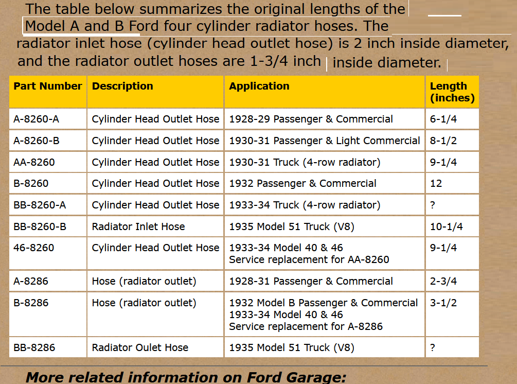

- Posts: 6545
Re: Radiator Hose Options?
Why not just order Model A hose & cut if need be?
Model T size Upper hose is 2"i.d. x 4" length. Lower hose is two, each 1 3/4"i.d. x 2 3/4" length.
Model A size Upper hose is 2"i.d. x 7-1/4" length. Lower hose is two, each 1 3/4"i.d. x 3-1/2" length.
RADIATOR HOSE SET 28-29 Part # A-8260/86 | Model Year 28-29 $22.00 set
This is the best hose you can buy. Red in color like Ford used. The larger size for the top and the smaller for the bottom for the 1928-29 Model A's.
Upper hose is 2" I.D. x 7-1/4" long. Short lower hoses are 1-3/4" I.D. x 3-1/2" long
RADIATOR HOSE SET 30-31 Part # A-8260/86-B | Model Year 30-31 $24.95 set
This is the best hose you can buy. Red in color like Ford used. The larger size for the top and the smaller for the bottom. 1930-31. U.S.A.
Upper hose is 2" I.D. x 9" long Lower hoses are 1-3/4" I.D. x 3-1/2" long

Topic author - Posts: 4396
Thanks Frank. I wasn't aware of the Model A hose dimensions. Looks like the way to go!

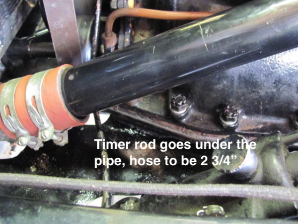

- Posts: 4046
The outlet hose in the kits is normally too long.
Cut it to the factory spec of 2 3/4" length.
That way the end of the hose is well away from the spark rod as it clears just the metal outlet pipe. Too long a hose there can interfere with the spark control.
John Illinois
