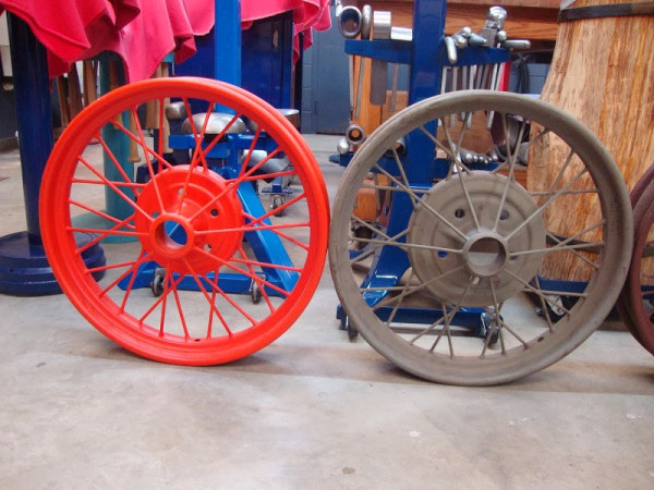

The centers are different, the A has concave look for the brake drums. The T on left, the A on right. The T has a tapered nose cone where the spokes meet. Many other obvious differences.

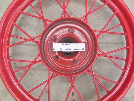

Or cut a narrow piece of cardboard 5" wide, for measuring the center lines of the bolt holes. The T is 5" the A is 5.5"

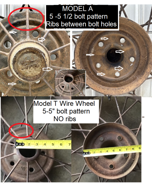

The most noticeable difference to remember are the ribs between a Model A wheel. The outer reinforcing ring is also positioned differently. Bothe have 5 bolt holes but their pattern is different

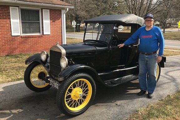

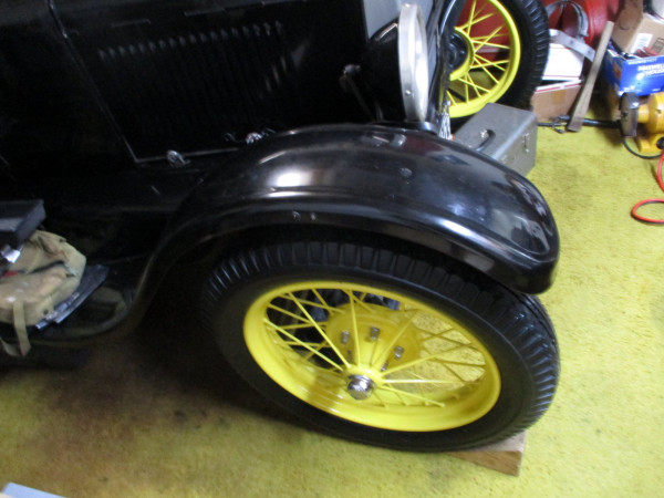

The 1928 AR Model T has the same bolt pattern as the 1927 T.
I found that out the hard way, after having two wheels bead blasted, repaired and painted.
Everything looked great until I added a new hubcap and it fell right through the hole.
That Model AR wheel is on my 1926 T Right Front now.
Jim and T.jpg (81.01 KiB) Viewed 2714 times

J1MGOLDEN
Posts: 1323
Last Name: Golden
Location: Bowie, MD
Re: T wire wheels vs. A wire wheels
Post by J1MGOLDEN » Tue Nov 28, 2023 12:16 pm
Sorry, left Front has the AR Model A wheel.
The one above is the correct 1926 wire wheel.

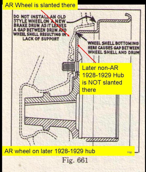

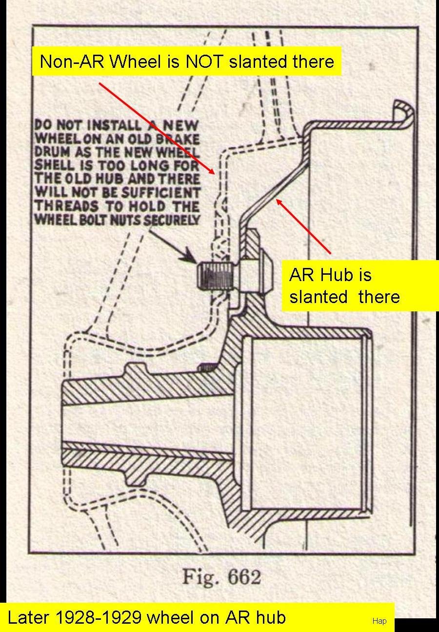

BIG Difference in AR wheels & hubs
J1MGOLDEN
Posts: 1323
Last Name: Golden
Location: Bowie, MD
Post by J1MGOLDEN » Wed Nov 29, 2023 9:16 pm
Thanks for the clarification!
That wheel did not seem to want to go on all the way.
I do believe there is a difference!
I have not used the car since the wheel was changed, but I bought another correct wheel, went through the same procedure and the hubcap fit!
I will get that one on soon! It does have a new Firestone tire and is ready for a drive.
