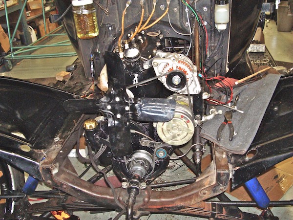

Can someone post a picture of the correct routing for the Timer connecting rod. Mine is all well bent up, and hits/rubs on a few items.

The rod should go from the lower end of the steering column, under the radiator hose and over above the timer. The exact bending of the rod is not important except for the following. It should not rub on the hose or any other thing while operating the spark lever. The length of the rod adjusted by bending it must be such that when the spark lever is all the way up, the timer should cause the spark to occur a few degrees after the piston reaches top dead center on the firing stroke. You can find many posts on how to time the engine. The exact position depends on your timer. Sometimes the rod must be adjusted when changing the timer. They are not all the same. Anyway, the important thing is to not have a lot of slack in the mechanism and have the length correct without rubbing on other engine parts.

Re: Timer connecting rod Image Request
Here's a picture of mine mine and a picture that I found in a catalog. Maybe U can get an idea from them
