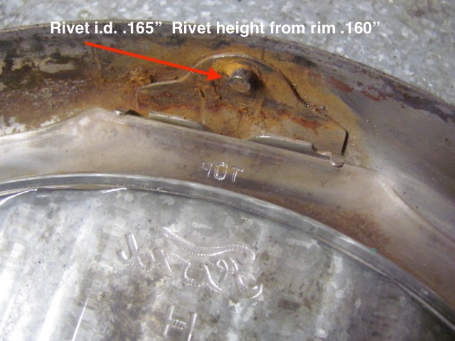

Here are the dimensions of the original tang of the 4 rivets on the headlamp rim. Use for reference.
