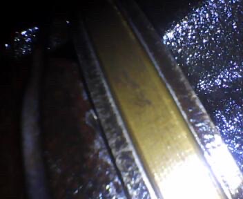

From this photo can tell if it’s Babbitt or bronze?

Post by RajoRacer » Thu Dec 14, 2023 7:31 pm
Hard to distinguish from that photo - Babitt will obviously be grey in color & depending on the rear axle lubricant cleanliness, the brass might be disguised by the color of the fluid !

Post by RVA23T » Thu Dec 14, 2023 8:44 pm
with the random striations I see on it I would think babbit more than bronze

Re: Ruxstell thrust washer?
Post by kmatt2 » Thu Dec 14, 2023 9:02 pm
You got the bore scope in there to get the picture, so try a long thin screw driver or something else, to scrape a little grease off the edge of the washer, maybe some solvent on a long shop towel would work. Then take another picture with the bore scope, you just need to see if it is yellow or steel gray color, of course the yellow would be brass.
Post by Tlitwin » Thu Dec 14, 2023 10:16 pm
Great ideas I will do it tomorrow and post a new photo
Post by KimDobbins » Fri Dec 15, 2023 2:00 am
I recently bought a very original 1916 coupelet and look inside the rear axle with a bore scope. It was pretty easy to see the yellow color of the brass washer.

Post by Wayne Sheldon » Fri Dec 15, 2023 6:17 am
Don't count on the color! I have taken a couple of Babbitt washers out of T rear ends that appeared to be brass colored only to poke at them and scrape the brass color off. What causes that? I am not sure, could be some type of oil used, or a contaminant of some sort. Maybe even something in the Babbitt mix? Whatever it was, it stuck to the Babbitt all the way around the things and looked like brass, until I scratched them.

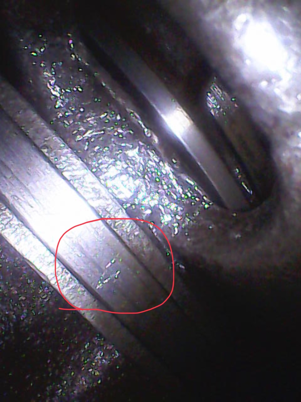

Post by Tlitwin » Mon Dec 18, 2023 1:42 pm
Finally got time to go check it some more. I first cleaned it with some acetone and then was able to get the tip of a Babbitt bearing scraper to make some scratches. Do to the silver color I am pretty sure it’s a babbit thrust washer. Looks like I need to plan to remove and rebuild the rear axle
Post by mbowen » Tue Dec 19, 2023 2:11 pm

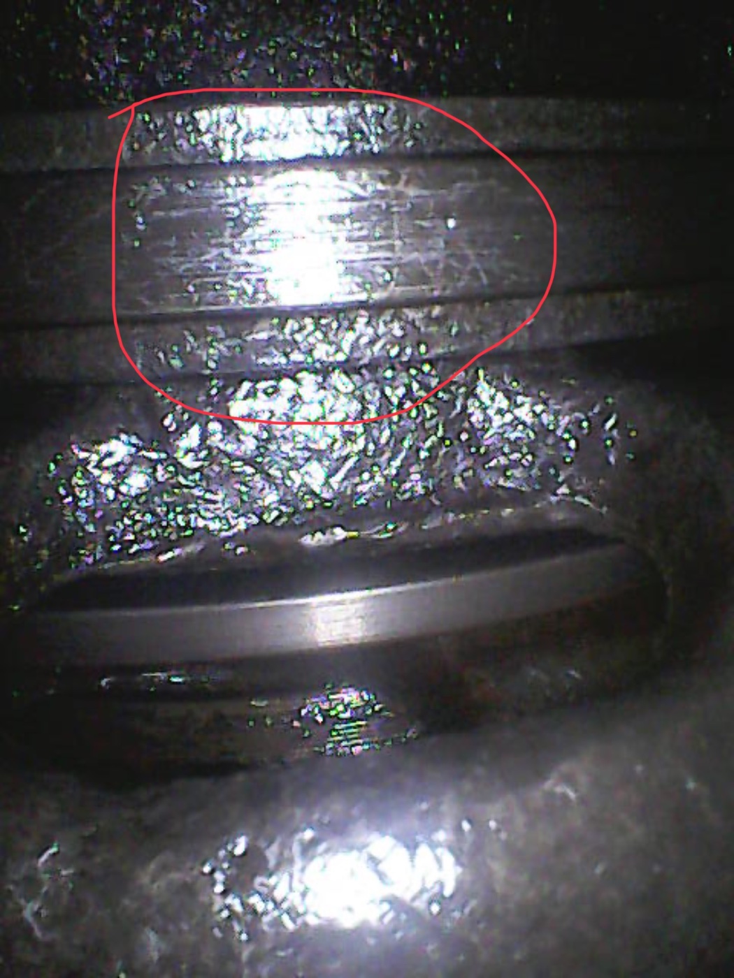

Yes, yours looks like babbit to me. Here’s a borescope photo of the one in my ‘24 touring. From the color, it’s probably bronze. Only the right side is accessible through the fill hole, and I can only assume the left one is the same.
