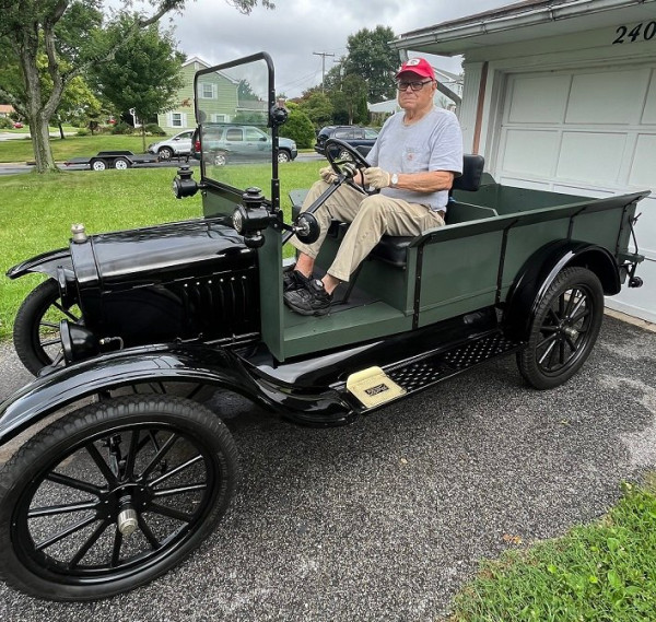

J1MGOLDEN
- Posts: 1323
- Last Name: Golden
- Location: Bowie, MD
Re: I am putting a starter on my 1916 coupelet.
There is more to that change than you realize.
You are going from a double coil Magneto Coil to a single coil and a smooth Flywheel to a starter ring Flywheel.
You also have to change out the wiring, add the battery box and a starter switch.
I did that on my 1917 T Truck after I had the engine installed in my test stand for a run in prior to installing it in my truck.
Cranking it once with forgetting to retard the spark caused the crank to rapidly work backwards from the 5:00 clock position.
I strong armed the crank to stop the reverse action, but that did not work well!
I was picked up off the driveway and thrown on the blacktop rather hard.
I was also knocked unconscious for an unknow period of time, as I was home alone.
Both thumbs were dislocated, on by the crank and one by bracing myself for the fall.
I had a quarter sized road rash spot on my chin and another one on the side and near my eye socket that size.
Every bit of my wind was knocked out of me and my abdomen swelled so much breathing was difficult for about the next five days.
I did recover, removed the transmission cover and oil pan and proceeded to install a rebuilt 1920 transmission and rewire the engine compartment.
That whole process took me one month to recover and 7 months to complete!
I opted for a solenoid rather that a correct starter switch.
The truck starts easy and runs great now!
My first drive day.
