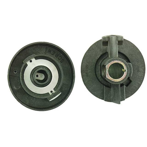

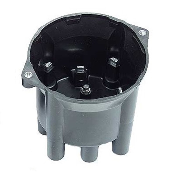

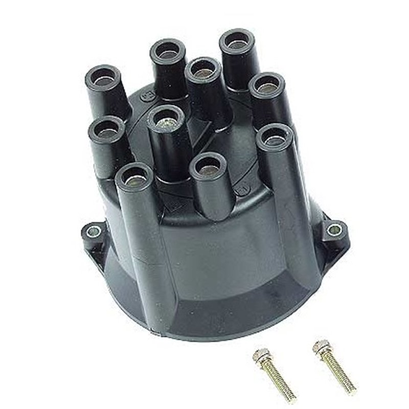

A place to buy cap & rotor https://www.partsklassik.com/p-2265-dis ... -plug.aspx
same as Nissan I believe
Distributor Cap 4cyl Twin Plug
Our Price: $18.56
Please start by selecting your Vehicle above. If you know our part number please select from options below.
8-Plug Distributor Cap
This is an aftermarket cap for twin plug conversions to 4 cylinder engines in 912 and 356 and Polo Motors.
Aftermarket
Our founders have worked on Porsche cars for decades. They've tried most of our aftermarket products first hand on real cars. Some parts are no longer made by an O.E.M company, or the price difference between genuine and aftermarket has become so large that it makes sense to take the savings. If you have any questions about an aftermarket product, please contact us.
Our Price: $18.56
Aftermarket
