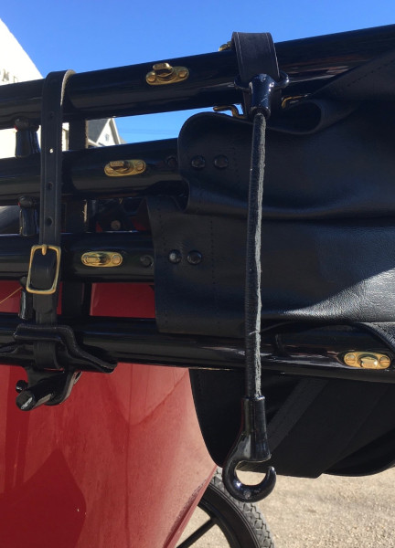

My top straps are correctly placed, unique and of a style not known by many. A footman loop holds the strap in place. They are a leather wrapped cable rather than the normal leather strap. Please see pictures below. Thank you for the method you use for lowering the top.

My apologies for "assuming" ! That is an interesting arrangement - what year is your Touring ?

1912, same as the two in the pictures.
