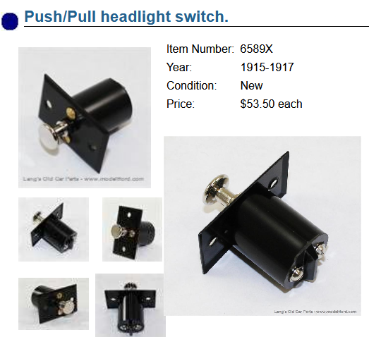

Post by TRDxB2 » Sun Dec 31, 2023 12:12 am

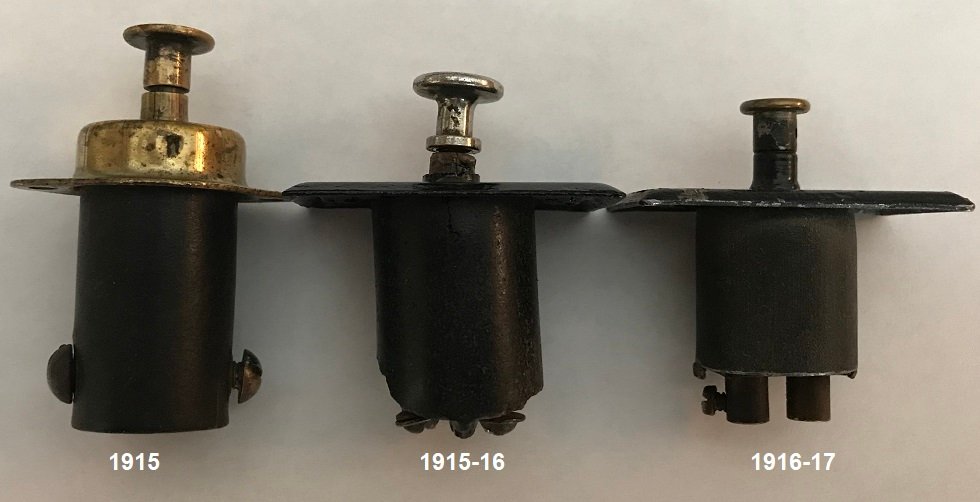

Its a dash mounted push/pull headlight switch. To be precise its a later model defined by the length of the cylindrical portion.
The first versions were brass, next was a long cylinder body, then shorter with protruding contacts. The repros are similar to the shorter style.
Good find $$. Note: The originals were a simple design to complete the positive wire connection. They need to mounted on a wood dash since they were not well insulated internally.

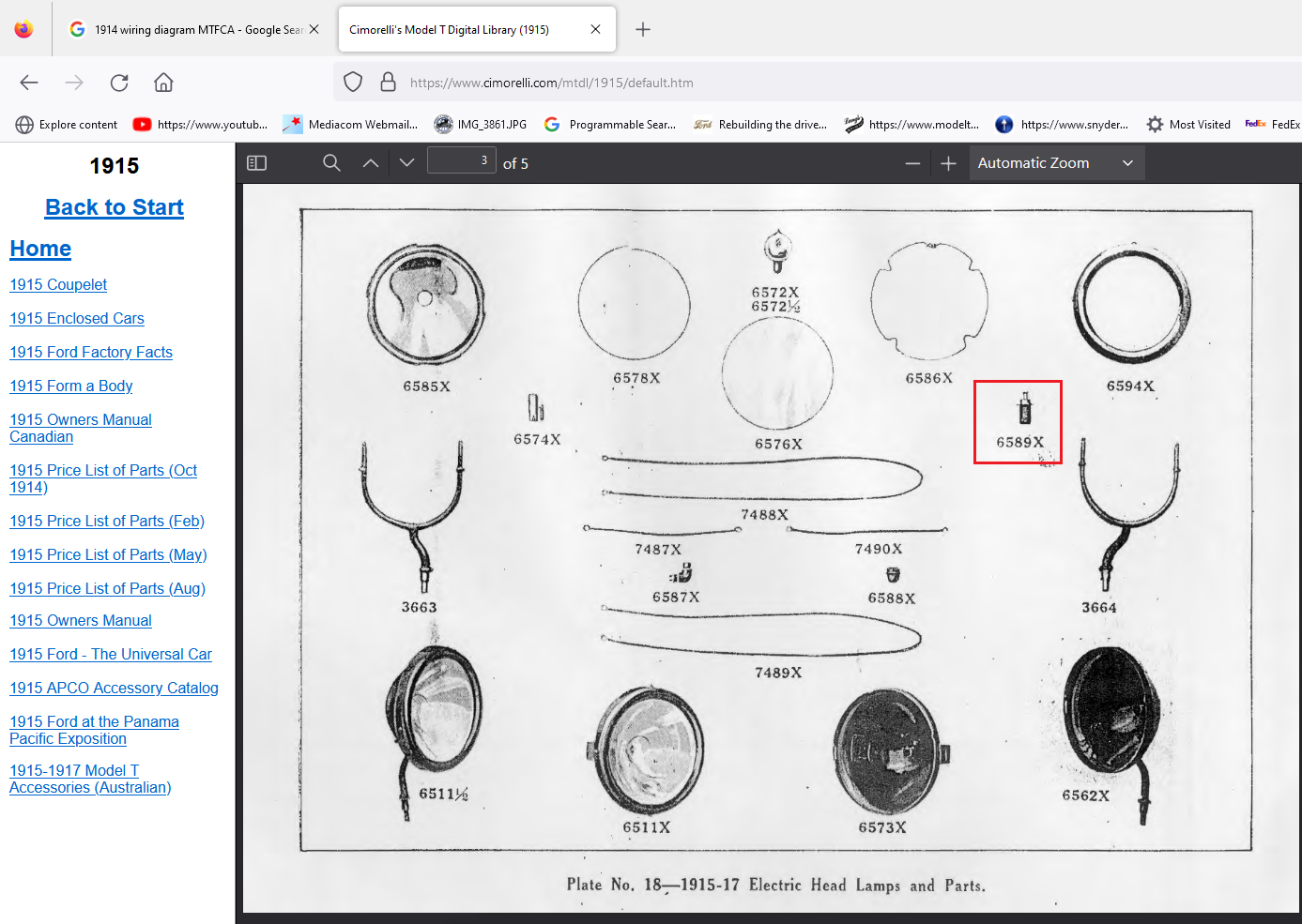

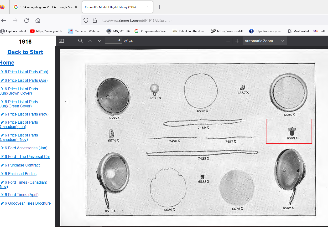

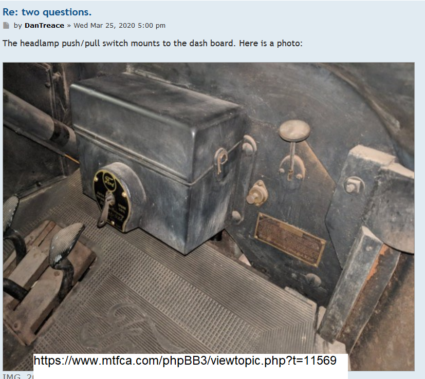

all mounted in the same position
