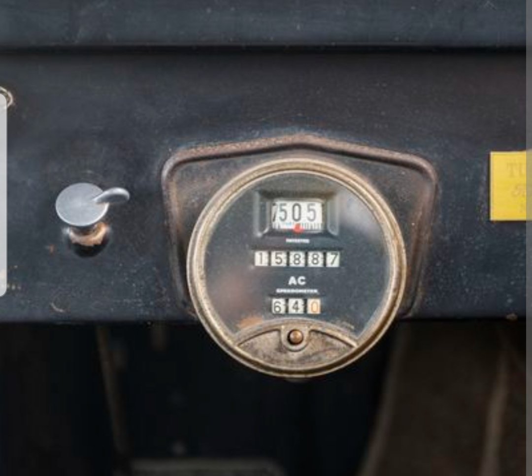

Should a '25 Tudor Sedan have a speedometer like this if at all?
Posts: 5597
Re: Speedometers
Post by RajoRacer » Sun Dec 31, 2023 7:36 pm
I believe so - all speedos were accessories by that time - Stewart most common - AC also available.
Posts: 5548
Last Name: Gregush
Location: Portland Or
Re: Speedometers
Post by Mark Gregush » Sun Dec 31, 2023 8:24 pm
If that AC speedometer still works that is a plus. Most all of them, the pot metal casting inside goes bad and is not repairable.

Sorry I should have posted that the picture I showed was a screen shot from online. I currently do not have a speedo and just noticed that there was a place for it on the dash that was covered up. I can also see a slot behind the dash where something should be.

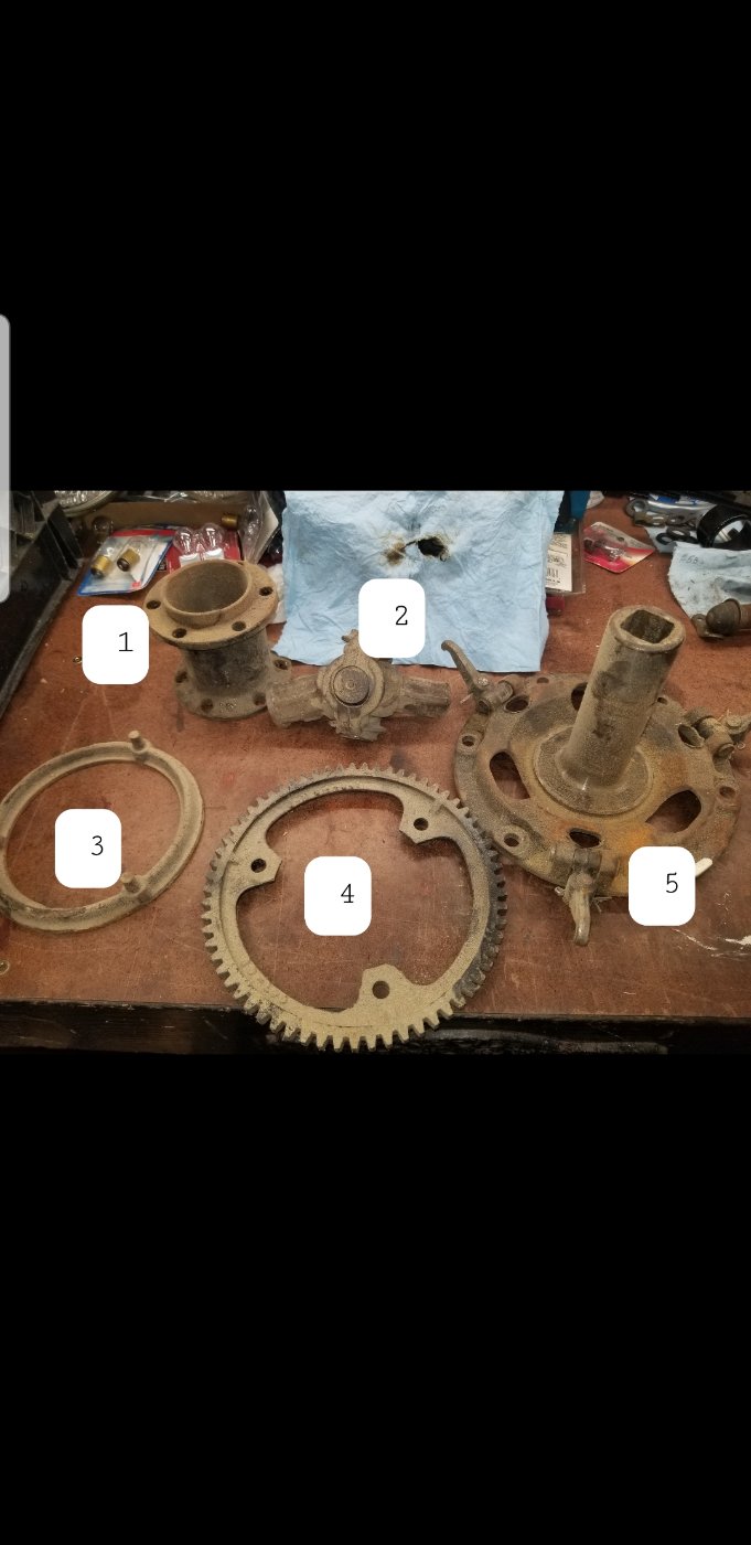

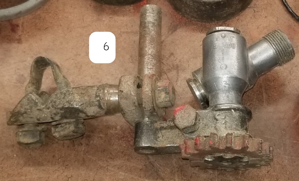

Are parts 3, 4, & 6 needed to hook up a speedometer on a '25?

vping wrote:
Tue Jan 02, 2024 2:26 pm
Reckon so. Get hold of Russ Furstnow if you can...he's the Forum's resident speedometer expert.

Not 3. That's the clutch pressure ring inside the transmission.

Rich P. Bingham wrote:
Tue Jan 02, 2024 2:43 pm
Whooops Rich! LOL...you're right about #3...wasn't payin that much 'tention!! My bad! :lol:

Verify your wheel size - you'll need the appropriate road gear - 23" wheel takes a 60 tooth - 21" takes a 58 tooth - pinion the same - 16 tooth - 8 pitch.
Posts: 7292
Re: Speedometers
Post by Allan » Tue Jan 02, 2024 9:48 pm
Buy a copy of Russ Furstnow's book on speedos. While you do need a swivel like the one in No 6, the angled one shown is not usual. The swivels also come with different drive ratios. Most T's used a 2.5:1 ratio. They also come left and right hand drive, depending on which wheel it is installed.
All of this also depends on the brand of speedo you have to mount. My Corbin unit, as supplied by the dealer, uses a cast iron 1:1 ratio swivel. I would first find a suitable instrument as fitted to a T, and then go looking for the components you need to mount and drive it. The book will be an invaluable guide.

Parts 4 and 6 are needed. Parts 1, 2, 3 & 5 have nothing to do with the speedometer. You will need 3 wood screws and spacers for attaching the gear to the wheel and a proper armored cable for sending the information from the sending unit to the speedometer. The gear diameter and gear ratio on the wheel gear needs to be the proper ratio for the speedometer and front right wheel you are mounting the gear and sending unit to, or the speedometer will give you the wrong speed and the wrong mileage. Russ Furstow will know what you need and might possibly have one to sell. He also repair speedometer that have stopped working due to swelled pot metal parts. I bought complete 160 and a 490 speedometer sets from him about 20 years ago. While I wanted to use the Model 160 because it looked nicer and had more functions, I ended up using the Model 490 set when I discovered that, due to the cowl tank behind the dash, the 160 would not fit. Jim Patrick

The AC speedometer pictured is a different animal from all the other speedometers. The fiber driven gear is cupped and laminated between two pieces of steel. There is no gear reduction or swivel and the drive gear on the wheel has rectangular holes instead of teeth.
If I recall correctly, it also drives off the left wheel. I can take a photo of mine if I remember.
