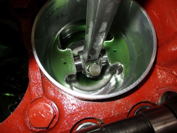

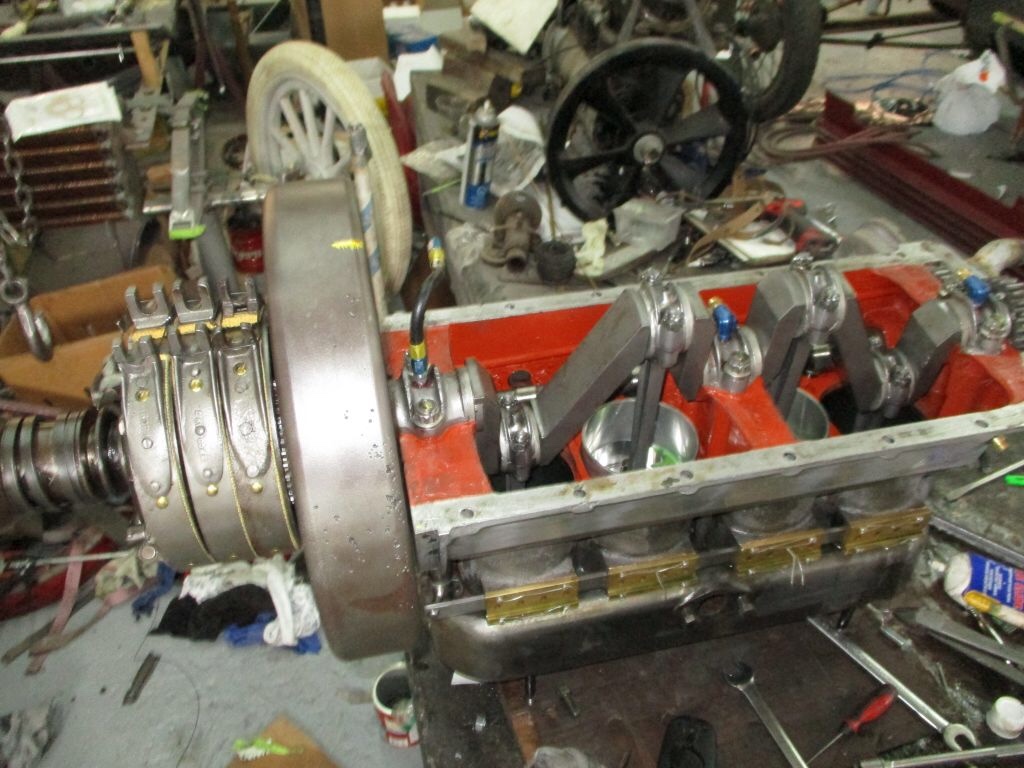

OK, not really Model T, but sort of.......
The Fawcett group are putting it together now. I'll post pics as it comes together.

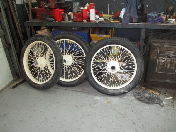

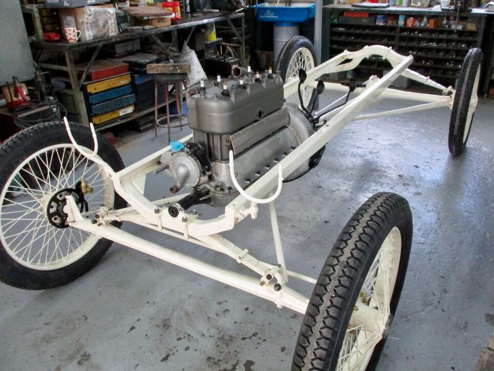

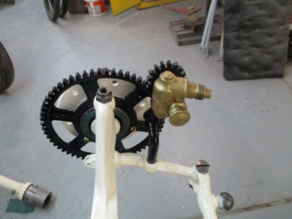

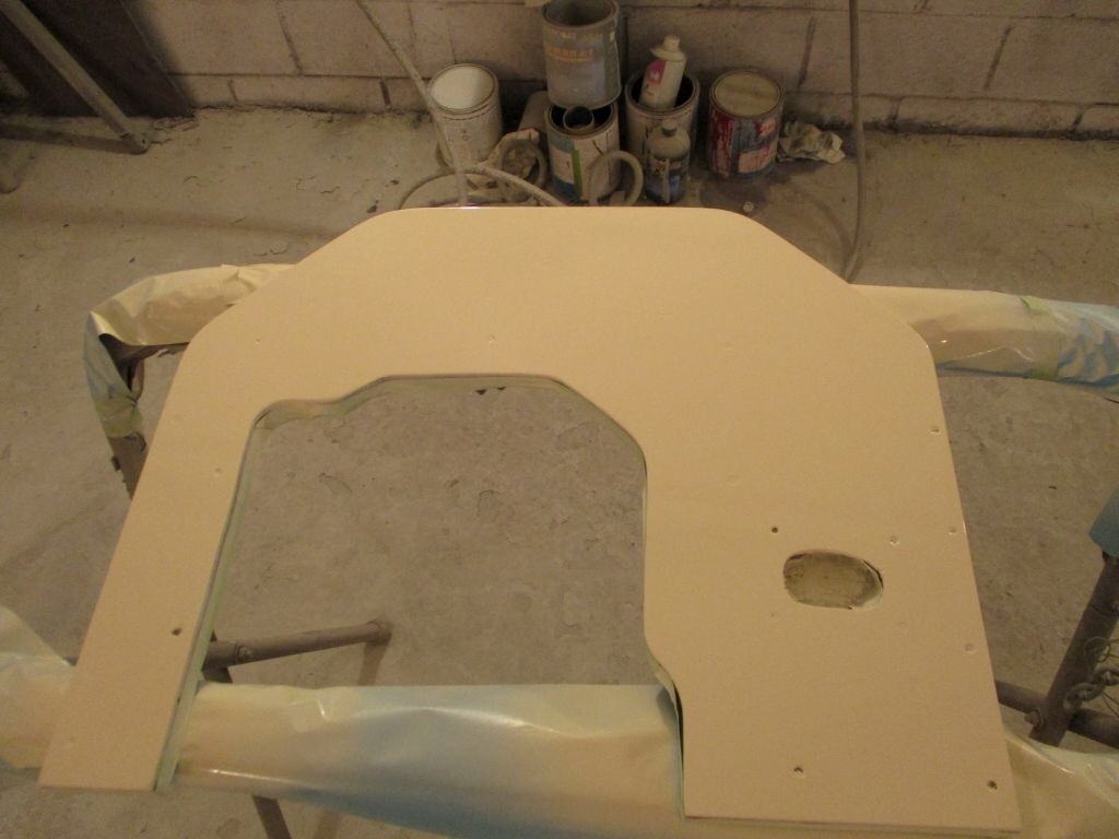

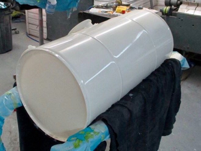

Firewall:
Wheels and hood are painted:
The carburetor adjusting rod and oil pump:
Peter said tomorrow the front axle and wheels go under the frame, and the engine goes in.

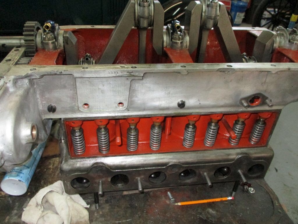

What are the bore and stroke?
Bill
Posts: 4407
Re: 1910 292 cubic inch Model T engine is going together.

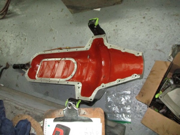

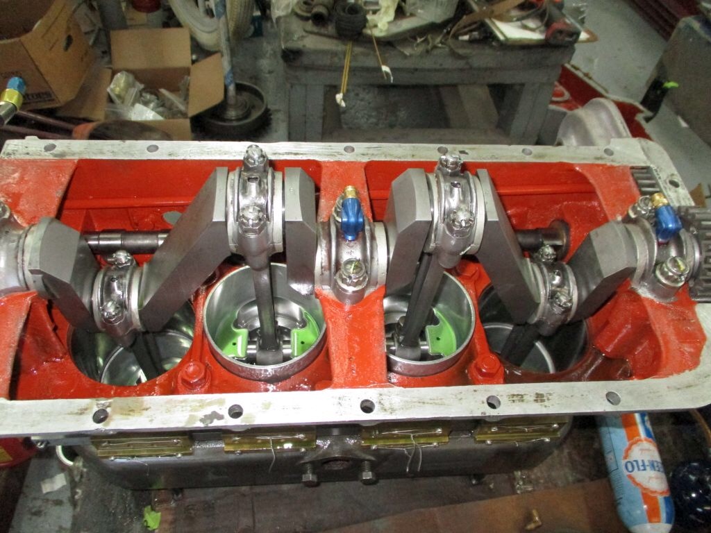

Post by Wayne Sheldon » Wed May 22, 2019 1:16 am
That motor intrigues me. Its similarity to a regular T motor, yet quite different in interesting ways. I can spot dimensional differences in the pan (lower crankcase), and the spacing between the removable bottom cover is quite interesting. It also appears to be cast aluminum.
Always looking forward to more pictures.
Rob
Posts: 1595
First Name: Rob
Last Name: Heyen
Location: Eastern Nebraska
Post by Rob » Wed May 22, 2019 8:00 am
Bill, the bore is 4.3125, stroke 5 inches.
Wayne, the motor is similar to the T in many ways, with these differences: pressurized oil to the mains, auxiliary exhaust ports (four holes with slide to close or open on the left side of the block), straight flywheel without magneto, front external magneto drive and magneto pad, waterpump similar to 09 version and aluminum lower crankcase come to mind.

Hi Rob, Thanks so much for sharing, I look forward to reading all of your posts. The history that you dig up is amazing. Does this car use same transmission parts as the Model T? Your oil system , reciprocating oil pump? It all looks great! Lincoln is getting closer. I am still waiting for my engine to come back from the machine shop. We will see you there.

John, it's a plunger type pump. A few more pics came today:

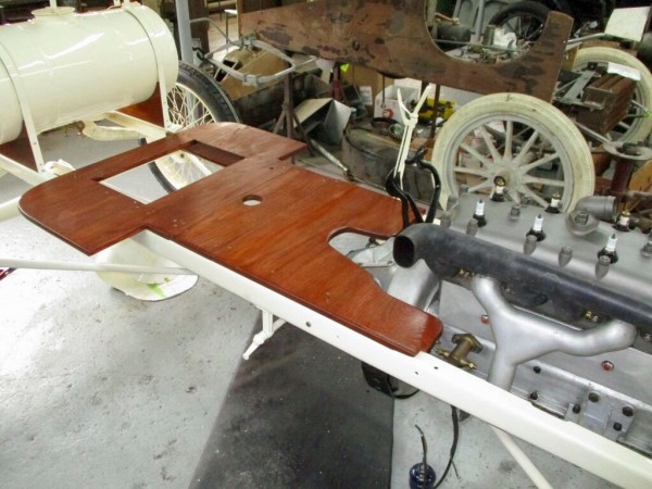

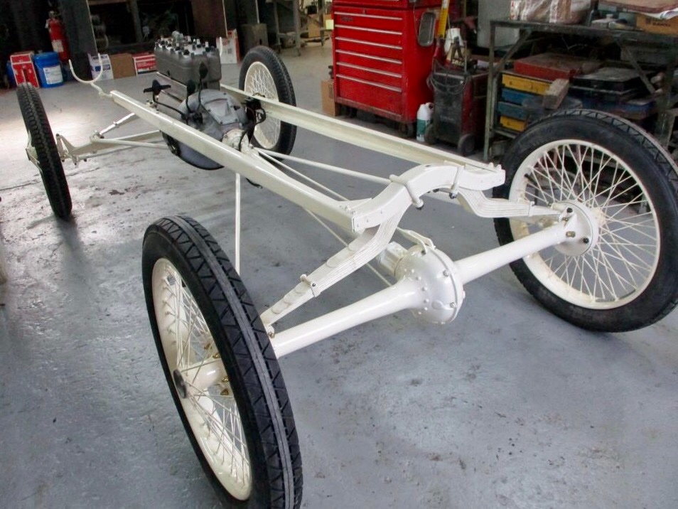

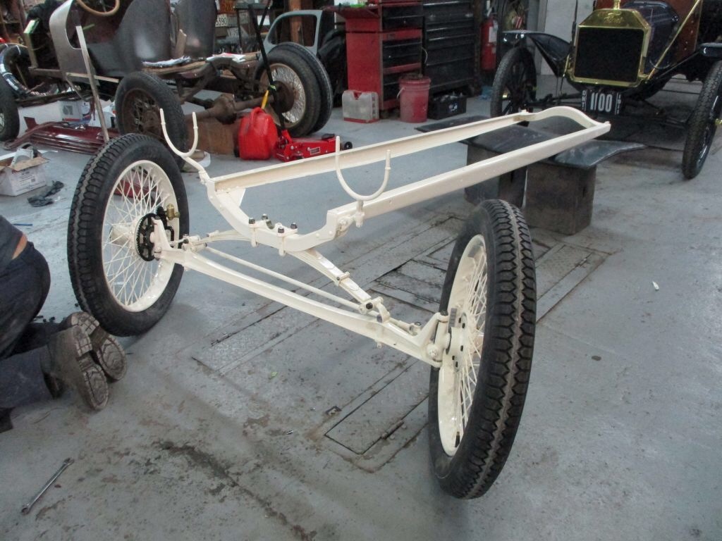

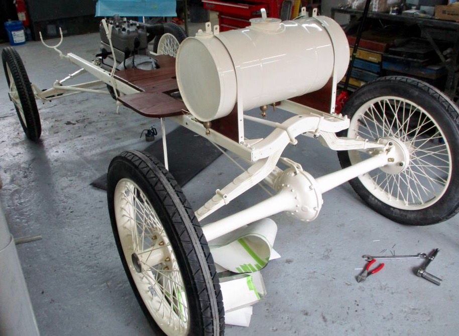

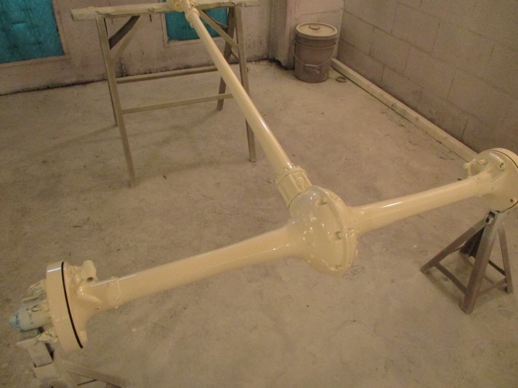

Two more pics in today. The pieces are going together quickly:
Posts: 2967
Last Name: Hjortnaes
Location: Men Falls, WI
Post by DHort » Fri May 24, 2019 4:56 pm
Rob
I see what looks like extra support rods on your differential that do not appear in the older photos.
I also see your front radius rod is over the axle. Any thought of putting an additional radius rod under
the axle?
Rob
Posts: 1595
First Name: Rob
Last Name: Heyen
Post by Rob » Fri May 24, 2019 6:44 pm
Dave,
The additional truss rods are on the racer at the Henry Ford. The torque tube had the casting for them so Peter made a set based on those at THF.
It looks like the wishbone was attached over the axle on the 1910 racers. The "newer" racer made in 1911 does have the radius rods under the axle, so Ford designers evidently realized attaching under the axle is stronger/safer. I plan to add under axle support at some point.

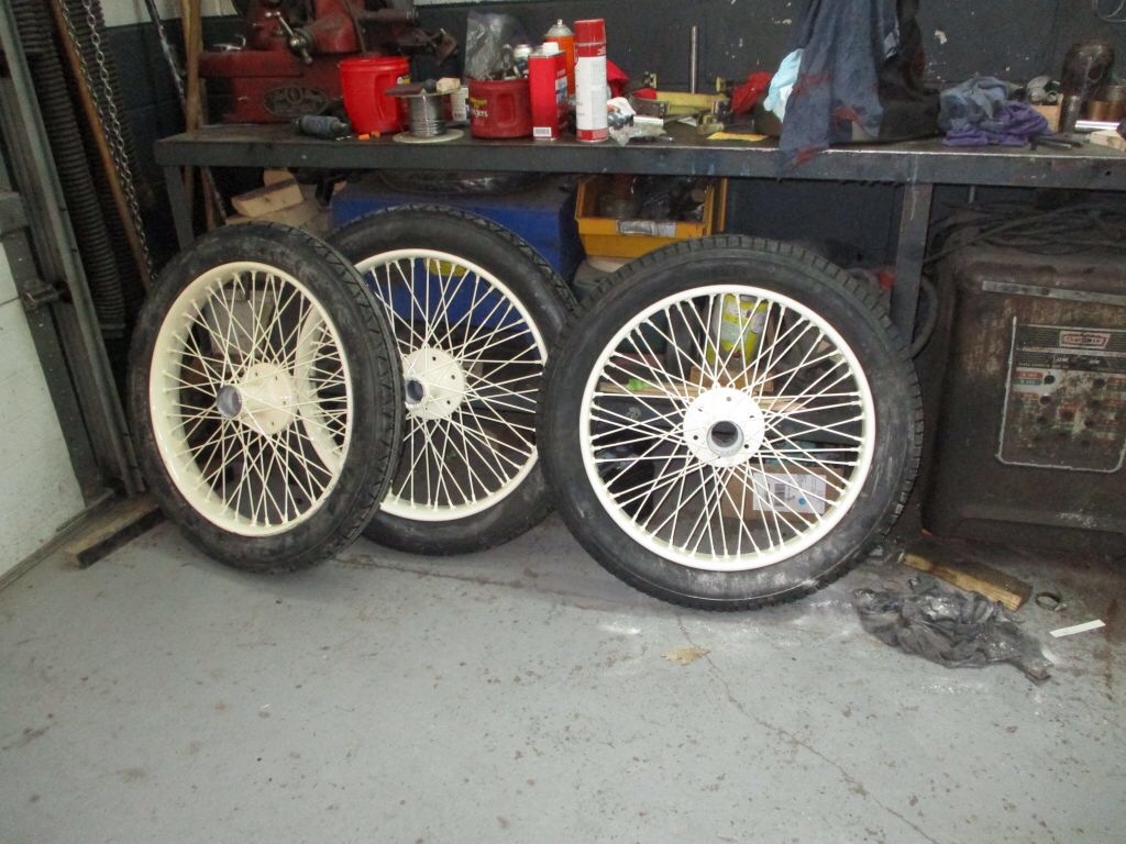

I noticed in the second photo, there's a mix of wood spoke and wire wheels on the car... wonder what happened back then?

I've noticed one wood wheel on the right front at a couple of different events. The wire wheels were 32x4, and the wood standard 30x3 1/2, so maybe they kept the wood wheel on for the speedometer?
A few more pics with the right front wood spoked wheel. First, at Brighton Beach races in August, 1910:
