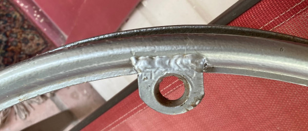

Post by George House » Sun Jan 07, 2024 9:12 am
Do it look like this ? If so, easily welded. I just didn’t dress it down before powder coating.

Post by jiminbartow » Sun Jan 07, 2024 9:22 am
Mine was V’d out from behind and the V filled with weld, for a cleaner looking weld. Jim Patrick

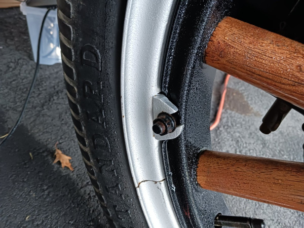

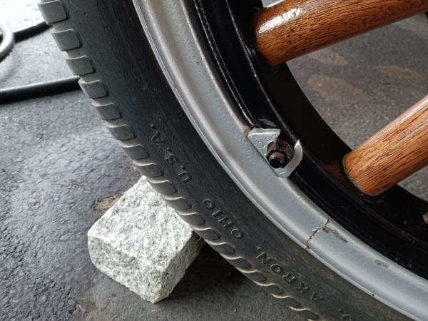

Post by TheSaintDiscJockey » Sun Jan 07, 2024 10:42 am
Here's how they look.
Two on each wheel rim.
Both located near the split in the rims.

Post by Adam » Sun Jan 07, 2024 11:54 am
They are supposed to be that way. That’s the way they left the factory. Without the split you have to stress the rubber valve stem to install the rim and is impossible to install a metal stem rim.

Post by John kuehn » Sun Jan 07, 2024 4:36 pm
Must be a different brand with the opening that way. I’ve seen several rims with missing lugs and loose lugs and welded on a few myself. Maybe I missed the brand with the split lugs. Don’t think they were all that way. If I missed the ones at swap meets I didn’t see them. There will be opinions about this for sure.

Post by RajoRacer » Sun Jan 07, 2024 5:35 pm
TT rear rims are a different animal than the car rims.

Post by Adam » Sun Jan 07, 2024 5:36 pm
His rims in the picture are the way they left the factory. It’s not an opinion IT’S A FACT. The rims in the picture are TT truck 23” Hayes rears… If you haven’t much experience with TT’s, it’s an often overlooked detail.

Post by TheSaintDiscJockey » Sun Jan 07, 2024 5:44 pm
I had assumed that these lugs had broken. Sounds like they are perfectly normal. One less thing to worry about. Many thanks for the insight!

Post by kmatt2 » Sun Jan 07, 2024 8:41 pm
I have a later 1924 - 27 TT with the 23inch Hayes split rims on the rear that are rusty, plus some other 23 inch Hayes split rims that are in good shape, all of these rims have the lug by the split like you show. That is so you can install the rim with inflated tire on the wheel with out forcing it on and bending the valve stem.

Post by Allan » Mon Jan 08, 2024 1:01 am
Brooks, I can hardly believe how good and flush the solit in your rims lines up. You are fortunate to have such good rims. Usually they are a bit mangled/hammered/miss aligned through years of being worked on by tyre fitters, some of whom were not well versed in the correct fitting procedures.
