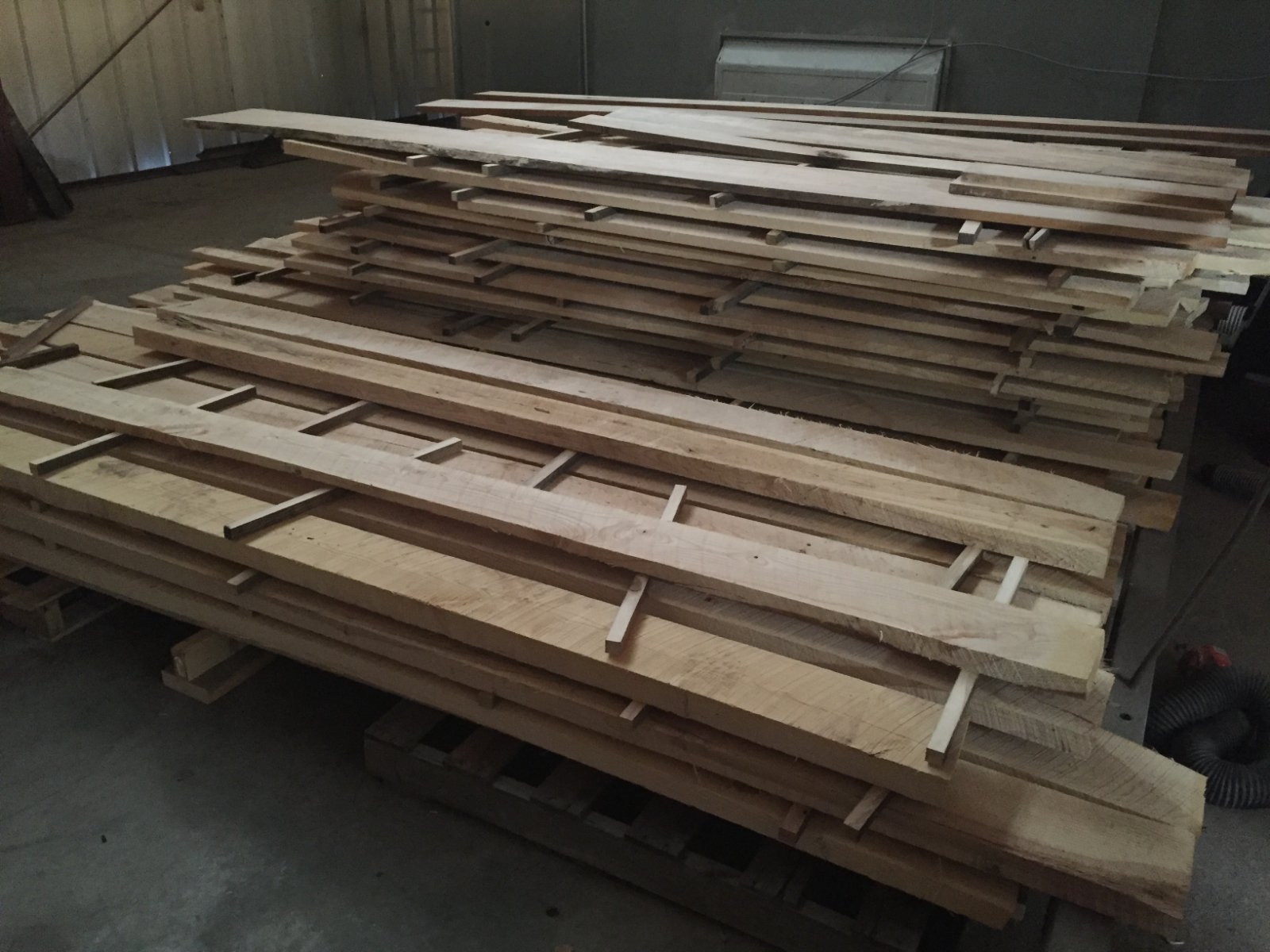

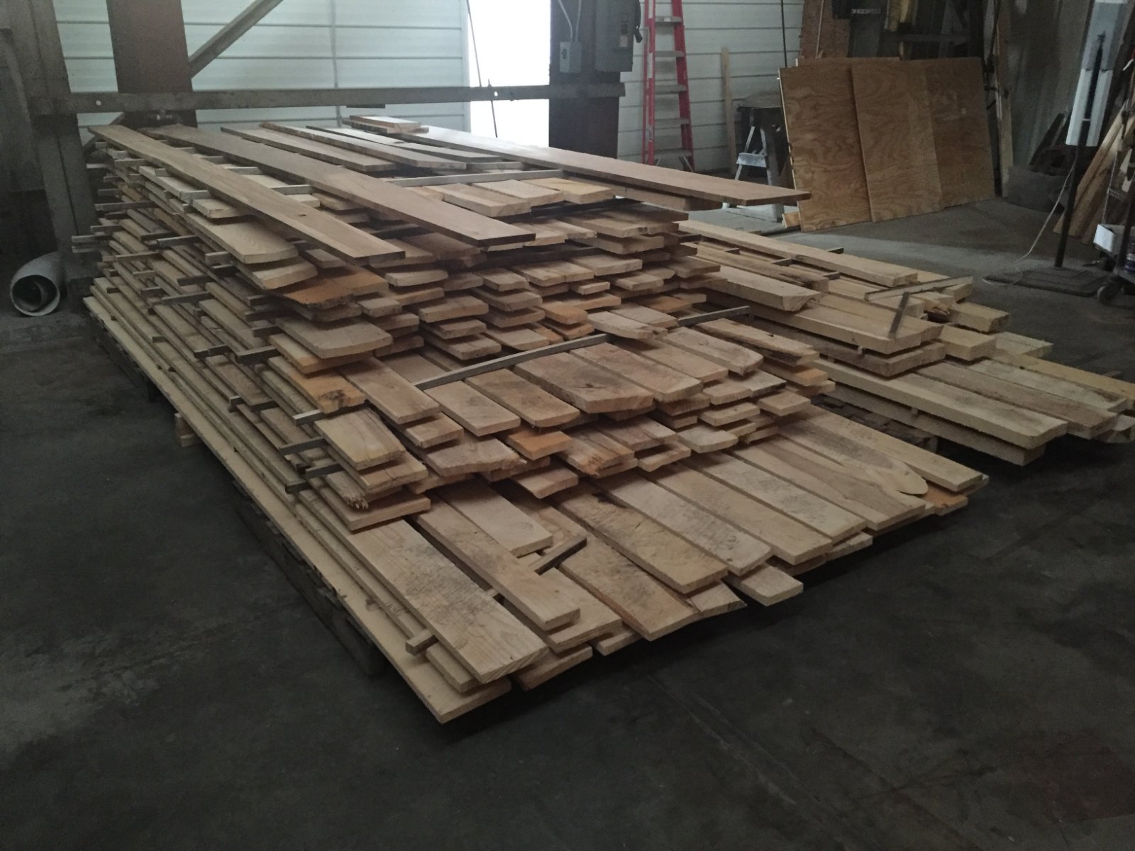

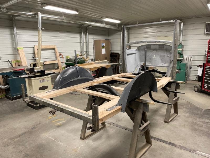

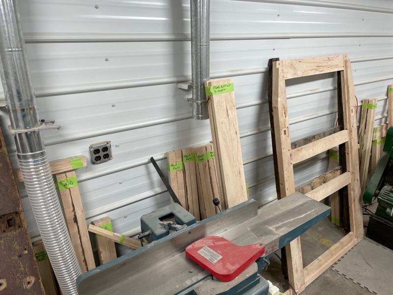

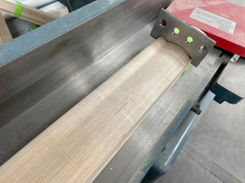

I have a complete wood shop in my restoration shop where we fabricate the wood for bodies that we are restoring. We predominantly use Ash, Hard Maple, & White Oak, -although the factory prints also list other species as suitable for use of these pieces. We generally go thru about 2000 board foot annually, and I generally purchase about third of it in ⁶⁄₄ thickness, about a fourth of the remaining in ¹²⁄₄, and the remaining (-along with smaller pieces in ⁸⁄₄ thicknesses. Maybe that will give you some idea as how to saw it. Much of what we do is glue-up pieces to rough-in the shape of the piece we are fabricating as a way to save material.
Because the Ash Borer has been prevalent in our area for years, we cannot always be that picky, and generally the Miller can tell if it will be ok to saw. It may has some small black spots on the wood from the Borer, however we can usually work around those spots. Because we steam some pieces, we air dry our lumber down to around 18% or less. Below are some pix of my wood pile, and some ongoing projects...

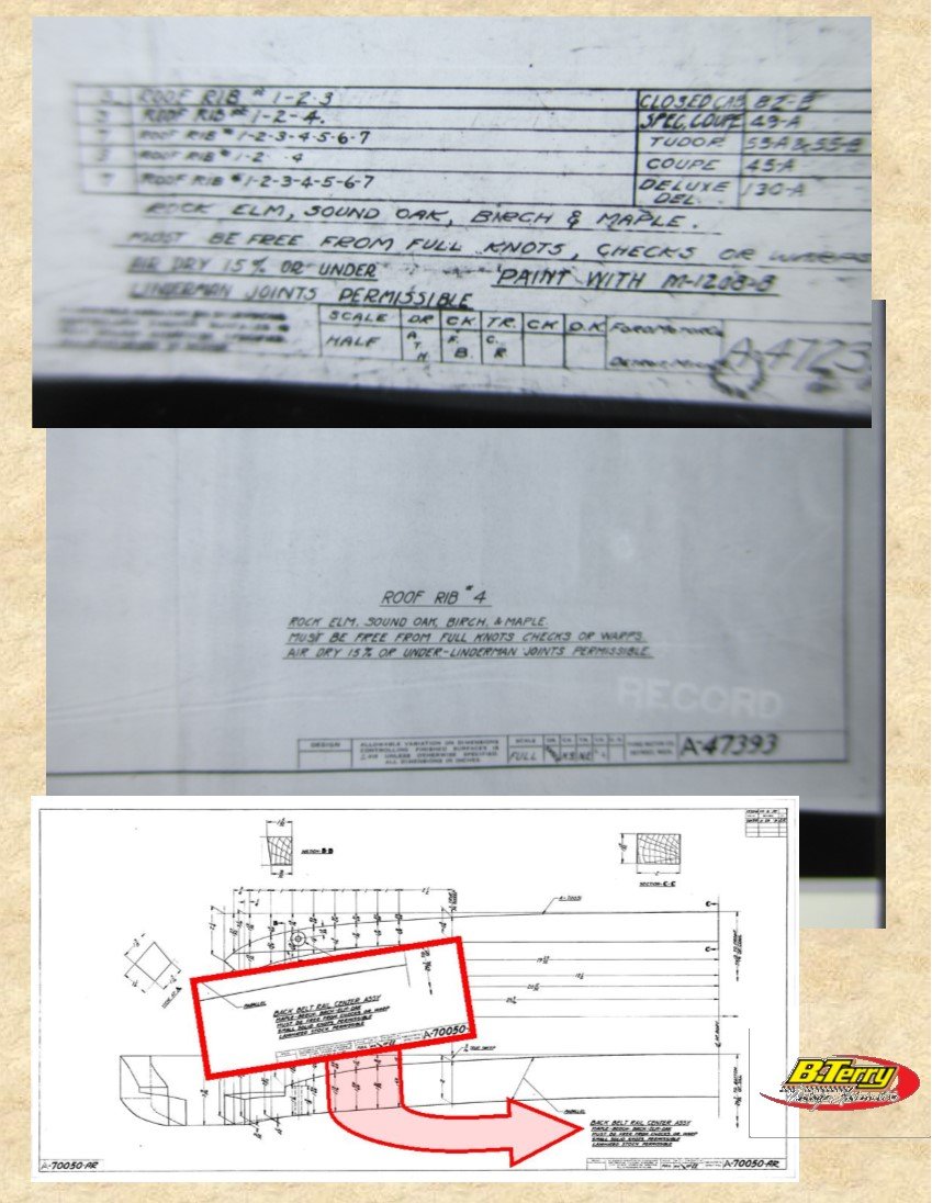

Interesting. I have not seen Poplar listed on any of my prints. Most of my Ford-produced prints are from the late 20s and early 30s, so maybe the Poplar had been used-up by then!!Rich P. Bingham wrote: ↑Sat Jan 13, 2024 10:45 amThough ash was the preferred wood for coach building, most open Ts were framed with poplar. It's still the best choice ! Resilient, great strength to weight ratio and good machinability. It's often mistaken for white oak, but oak can't compare in quality for the purpose.
I wouldn't be too concerned about specifying plank sizes. A nice assortment of 1", 5/4" and 8/4" up to 12 foot (or as long as the saw-log will yield) would be ideal. I wish we were close enough that I could get some. Good on you for thinking to conserve that lumber.
If I were ordering sawn wood, I would suggest thinking hard before ordering the ⁴⁄₄" and the ⁵⁄₄" sizes simply because the finished milled sizes of the ⁴⁄₄" & ⁵⁄₄" will be awful thin by the time both sides are planed for use in those longer lengths. (Consider the sizes of door wood, body wood, and sill wood.)

Two thoughts come to mind on this though. The early cars with outsourced manufacturers of bodies likely did have all kinds of wood species. Also, I have never seen M-specs dating back that far, so it is likely old Hank did not have his Q/C department in full swing to ensure the specified wood was actually being used. And, by later years, I think Ford's engineers just spec-ed anything that was growing in Ford's Forests as long as it resembled a hard wood. One of the loggers likely told the engineers what species they were cutting at the time and the engineer wrote that on the print!!
