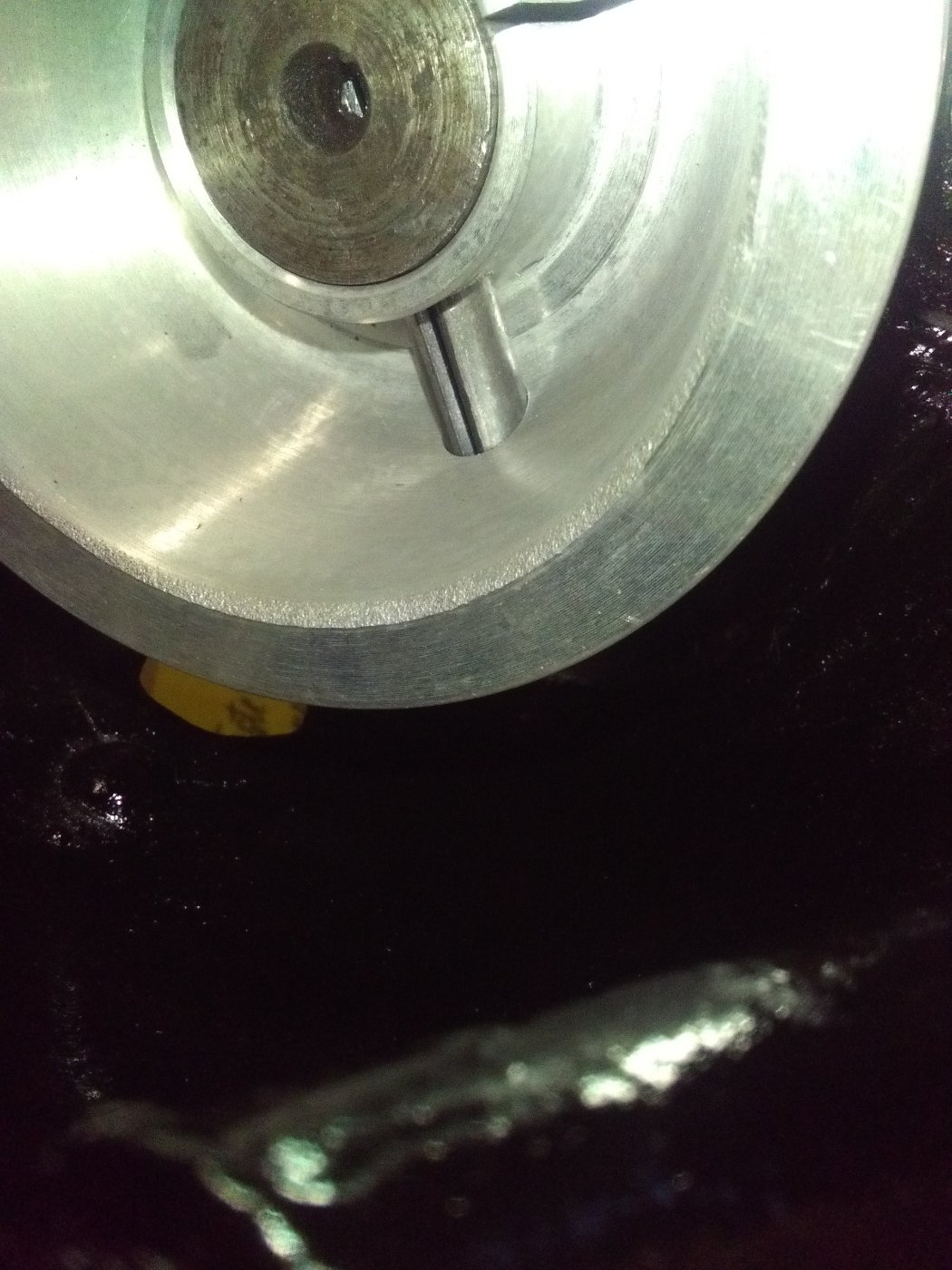

What is the best way to tighten a loose crankshaft front pulley?
New ones are not being made and I have 6 that do not look worn, but all of them are loose.
It appears the crankshaft may have been smoothed with a slight reduction in size.
A new aluminum pulley fits tight, but the pin is right up against the pulley rear and the crank cannot be used.

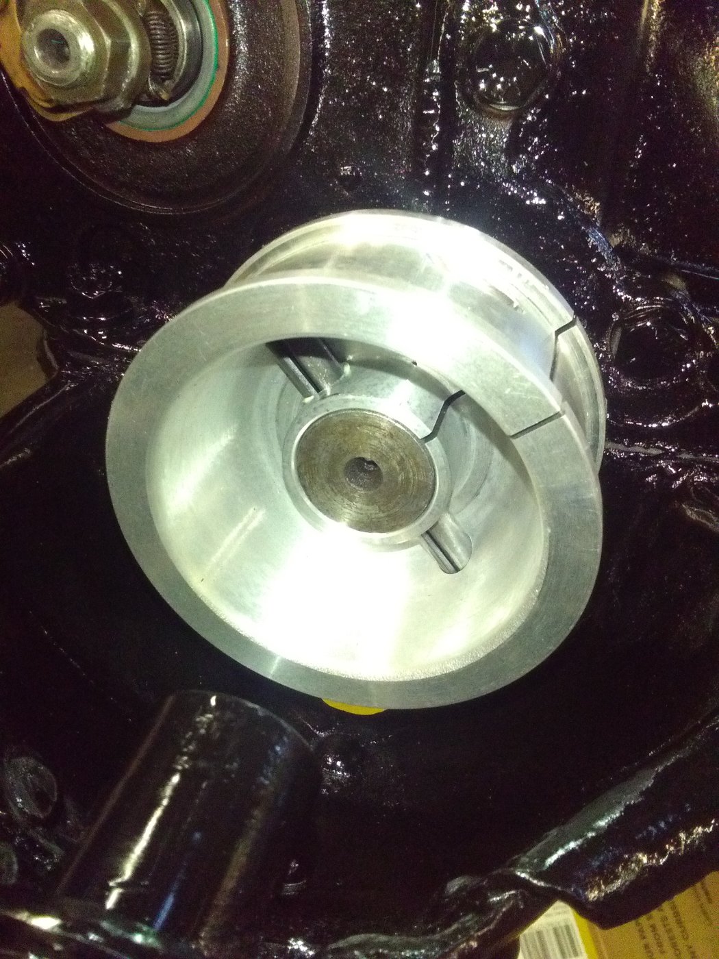

I just put a split one (aluminum - new) on an engine here - had to spread it with a screwdriver to get it to go on, roll pin was hard to install and there is a set screw "clamp" in them. It's on now and definitely won't rattle like the old one.

Is the pin far enough forward to let the crank engage the pin?

Does your pulley look like this? This pin is positioned correctly to engage the ratchet properly.
Yes, the roll pins can be difficult to install, but reshaping them to reduce the diameter when the crankshaft hole is not worn helps quite a lot. They can be squashed in a vise along the length to do this as needed.
Loosening the clamp screw or removing it completely for installation may also make slipping it on the crankshaft easier. Additionally, a beat up pin hole often times creates a substantial burr on the edges of the hole that should be filed down smooth.

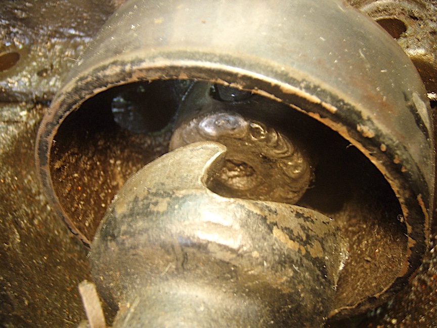

Dan, I just received a couple of the pulleys in question:
The ratchet teeth if you will, cannot not wrap around the pin, the ratchet hits the back of the pulley wall first, so not enough clearance for the teeth to catch to pin. I tried new crank ratchets, old worn, none will allow the teeth wrap around the pin to prevent slipping when hand cranking.
