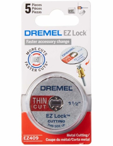

Why do you want to remove the quadrant? If the teeth are worn down, you can file new teeth onto the existing quadrant with a dremel tool quipped with a metal cutting wheel, if you take your time and are meticulous and careful. Jim Patrick

Finally, I consider hand filing "new" teeth to be an exercise in futility. For a start, I know of no file which will produce teeth with the appropriate rake to suit the pawl. If you resort to a Dremel tool to shape them, good luck with getting consostency of profile. So much time and effort to produce a second rate job when perfectly adequate replacement parts are available, except for RHD pawls.
