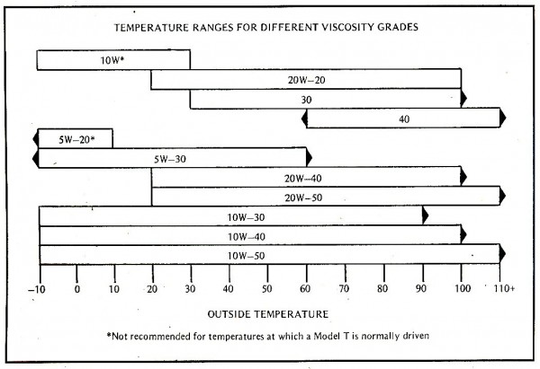

The oil Ford recommended for Model T use was SAE 20. I mistakenly assumed that 5W-20 would be OK. It's not, and I suspect that may have been a contributing factor to my rod failure. This chart from the MTFCA engine book shows the various weights.
My oil page has a link to Royce's excellent article on oil: http://dauntlessgeezer.com/DG103.html
