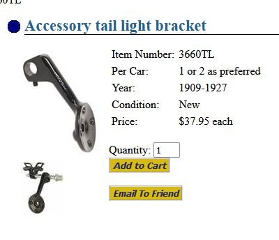

I have two if these lights I am going to use for brake and turn signals, lens is about 3-3/4 diameter. I see at Langs they have a red lenses for this and say they are for a 1915-27, is there a bracket for this lights for a 1927 Touring or do you just use the bracket from Langs part 3660TL

They are not appropriate for a 27. Your lights should be electric. There is a repop brackets available for left & right sides.(they fender mount)
Frankly, those earlier lamps wouldn't look right at all. Your choice.

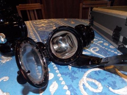

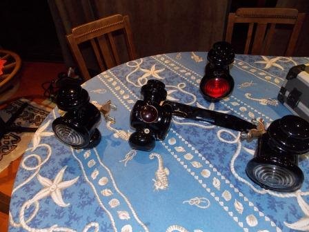

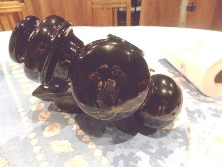

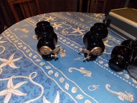

Bruce,
For the 1926/27 NON electric car you should need these brackets and lights.
I used them to install stop and flasher lights on my touring.
Pay attention the original tail light has the big lens clear glass and the small lens red.
On the back of this lamp you should find MODEL O.
Good luck
Andre
Belgium
Good luck
Andre
Belgium

Andre, our Canadian sourced cars had large red lenses to the rear and small clear lenses to the side. I wonder why yours are the reverse?
Allan from down under,

It sounds silly, but it was to put enough light on the license plate to read it at night, and still have a valid taillight that was visible to the rear... the easiest way was to make the big window (with the door) clear and aim it towards the plate, and make the former clear window red and aim it backwards as the tail light.
