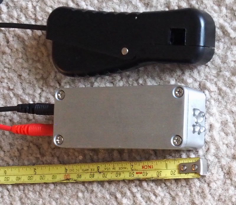

I have hit & miss engines, some of which use the Ford buzz coil for ignition. I have designed and built a LED timing light that runs on a 9V battery and has a clamp for the spark plug wire. The buzz coil produces a bunch of sparks when activated, but my design will only flash on the very first spark. Would there be a use for this on checking the ignition timing on the Model T Ford engine? It would show if each coil is firing at the same BTDC value.

No, not useful for a model T.
But for those that do not understand the T ignition system, they will probably buy them like hot cakes and you will be rich beyond your wildest dreams.
Am I responding to a bot?

It’s an interesting concept. The same thing can be accomplished by wrapping aluminum foil around the plug wire and using a standard timing light. Been doing it for years.
Your results may vary.

Thanks for your replies. As opposed to the ECCT, which I greatly admire, (albeit a bit expensive), my tester would show small differences in the timing output of the coils while they are actually operating from the magneto/timer in a running car. This would not only show differences in the coils themselves, but also show effects of timer irregularities. You would need to mark the fan pulley with a mark for TDC. It would also uncover occasional cylinder misfirings. A simple automotive timing light would fire repeatly as the buzz coil fires multiple times, which makes it unusable for buzz coil systems. My tester only flashes on the very first firing and ignores the rest of the firings from the buzz coil.
BTW, I owned a '14 T, so I am familiar with them.

Your method of wrapping aluminum foil around the spark plug wires when using a standard timing light integers me. I understand that the timing light doesn't see the secondary coil firing.whenBut, I don't understand how the aluminum foil does this. I am not an electrical engineer but have a fairly good understanding of electricity.
With your method of evaluating coil characteristics, I will be able to semi-retire my dual channel oscilloscope by using my timing light. I am anxious to try the foil when the car comes out of winter hybrination in the spring.

I would encourage you to bring such an item to market. More the better in having affordable diagnostic products available.
I have used a modern timing light. I didn't notice multiple sparks/ light fires. Maybe they were not noticeable due to the motors running speed.
(no wrapping with foil needed)
You would need to mark your pulley @ tdc & 180 also to view cyls 2 & 3.
The light will show firing variations & misses, but how do you distinguish the error in coils, timer or combination of both?? - By switching coils around to confirm or eliminate timer error? Can you easily determine which is the fault?
I have used the timing light to check accurate timer firing by using a fresh ECCT tested set of coils. Good test to find variations in an anderson type timer to determine which contact(s) needs tweaking.
To check the coils alone I would use a known perfect timer unit. That can be tricky also. Is the fault in the timer and or brush contacts, the centering of the cam cover or a dirty timer?
Anyway, carry on. Maybe I gave you something new to think about.
Think about including a comprehensive set of operating instructions with the product.

Thanks for all your mostly encouraging comments. I use my timing light on my hit & miss engines to check when the ignitor or spark plug fires. It works with magneto, battery + coil and buzz coil systems. I’m just a hobbyist that came up with an idea that I thought might be helpful to the T community. I have no desire to sell them for a profit. Its very simple to use; just clamp the pickup around any one of 4 spark plug wires and point it at the fan pulley that you added a TDC mark on it. Not sure why you would need another mark at 180°that speedytinc mentioned.

Good question Art, I started doing this when multi spark ignitions came out in the 80’s. The first spark is the strongest and the foil reduces the sensitivity of the timing light pick up so it doesn’t register the weaker sparks. To be honest I’ve only used a light on a T a couple times because there really is nothing to see as the timing is set statically.
