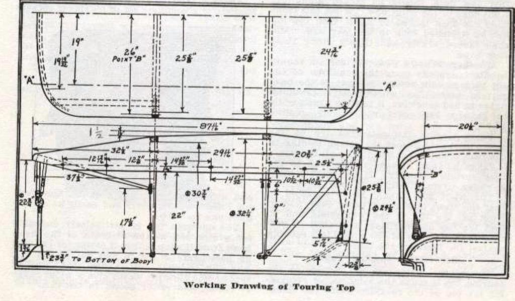

would this help?

Oh yes! Thanks!!! It may be a 1915 (based om what I can see of the firewall), but 'i think the dimensions are the same.
Where does that come from? Any source?

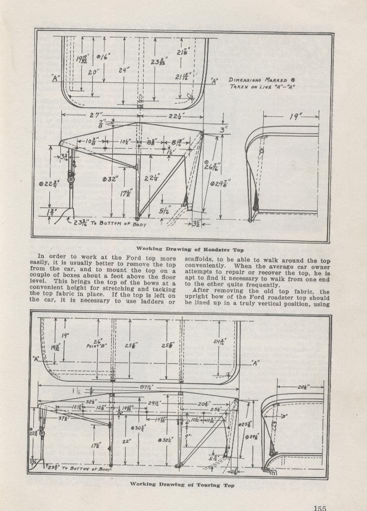

Oh, jeez, Michael, I can't remember. It may be from "The Model T Ford Owner" by Murray Fahnstock. I think I have a little clearer scan under another name, let me find it and post it.
is that any better?

That Murray Fahnestock drawing of the touring and runabout is from 1921 issue, so it's for a '21 or '22.
