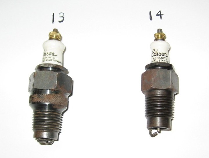

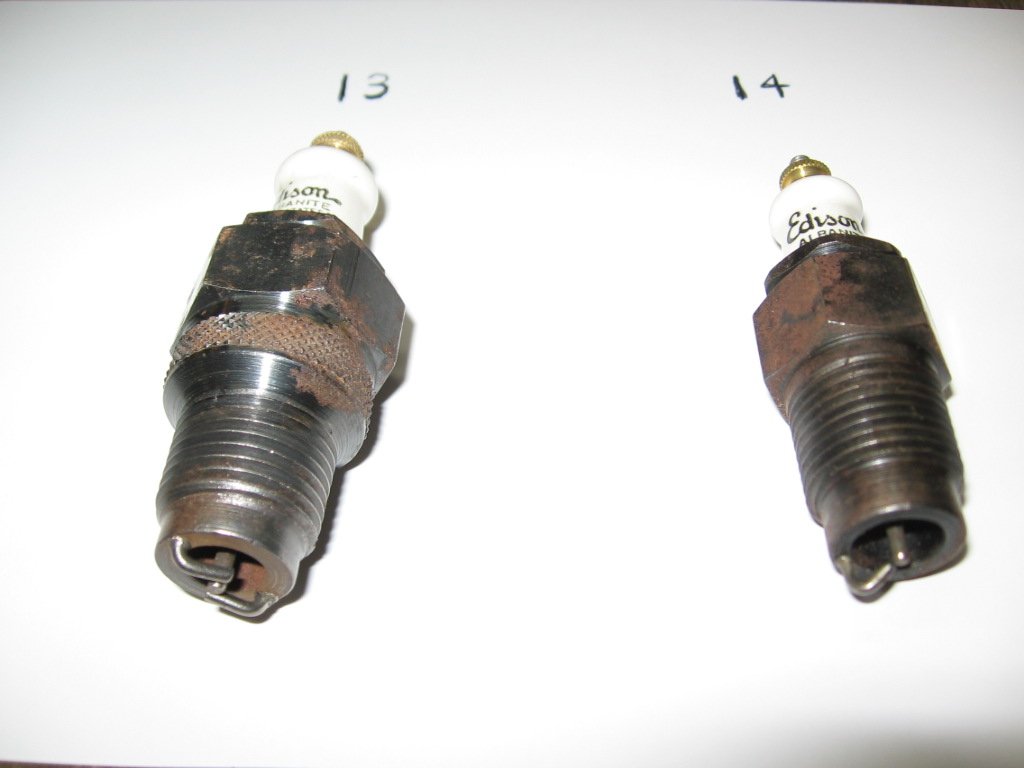

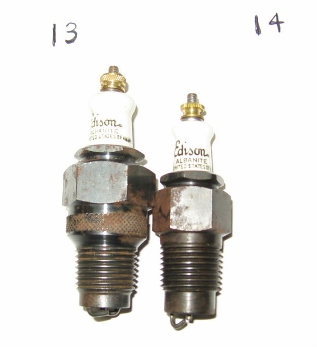

And right you are. The Edison 13 is a somewhat larger plug and requires a larger than standard T plug wrench. However its most important distinction is that the base is a dual fire. Whether dual fire has any real advantage or not is still debated. Although most automotive engineers seem to believe the advantage is minimal at most.
The Edison 14 is about the size of a common Champion X, and regular single fire base.
Both the Edison 13s and 14s changed in details over the years. some can be taken apart, and some cannot be. The size and placement of ridges varies as well. Putting together a set can be difficult. I have three Edison 13s I have been trying to find a fourth for a set for thirty years now. Now the problem is also that I took one of them to a swap meet years ago to try to match it, and somehow misplaced it when I got home. A household move since has had either the single, or the pair show up at different times. But it has been almost twenty years since I have seen all three of them at one time.

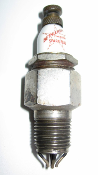

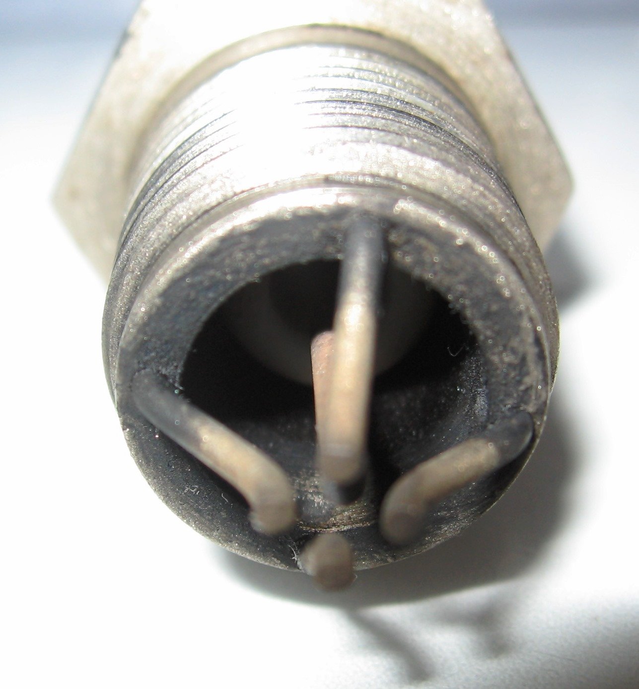

I think it's difficult to get a "dual fire" plug to actually fire to both ground electrodes under operating conditions. There are almost always small differences in the gap or electrode profile that will allow one electrode to fire at a lower voltage than the other. That is the electrode that will fire, unless you have a VERY hot coil. One advantage that a dual electrode plug might offer is that, having two electrodes, the one that fired most would erode first, and at some point the second, un-worn electrode would begin firing, assuming it was gapped within the correct range. I believe the principle use for dual or triple electrode plugs was in large stationary engines that ran all the time, or most of the time, such as a mill or powerplant engine. In those applications, a plug might perform for a very long time before needing any service or replacement, thus avoiding shutting down and re-starting the engine.

I believe Pat is correct about the spark jumping to just one ground strap at a time. That didn't stop manufacturers from trying all sorts of ground strap configurations.

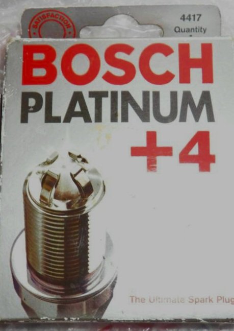

Nothing is new under the sun.
They still try this multi point spark crap today they are called e3 and don't for get these bosh plugs that would lose the tip out of the electronics!

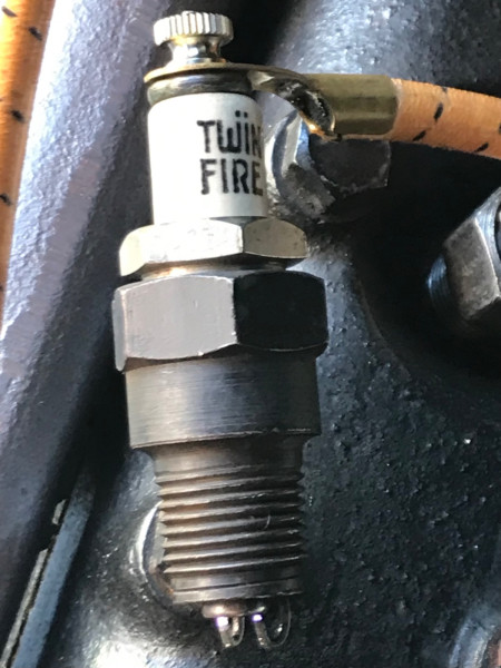

On the topic of spark plugs for T’s with multiple electrodes, the only one I know of that always makes multiple sparks is the aptly named Twin Fire.
