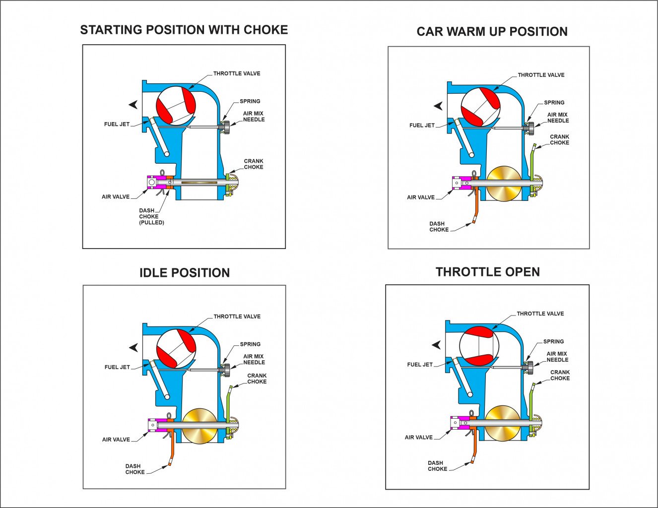

- Posts: 6594
Re: Getting 1927 Model T Running
Don't know if you have these but just in case from Forum's VowellArt Gallery pages
- Attachments
- Black_White Flow Diagram of Kingston B1 Gasifier Vaporizer Carburetor.jpg (8.02 KiB) Viewed 1056 times
