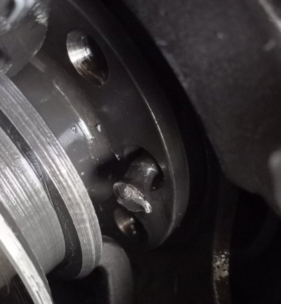

Here's another reason to open up the top of your trans. and inspect! While this is rare, it does happen! Unfortunately things went south here before I coulda spotted it but heaven forbid anyone else's trans. experiences this just maybe they'd catch it in time while having the lid off.
- Attachments
- 20210509_090925.jpg (42.52 KiB) Viewed 1978 times
