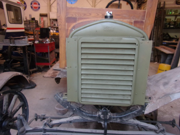

Sorry for monopolizing the forum lately, but there is wisdom in the masses. So, I messed up and it's not a deal breaker, but wondering if I can cobble something up or if there are some other options to bail me out. Installed shutter on front of radiator grill because I had one is tock and I think it looks very military for my WWI ambulance project. Got it all loosely installed and a rod to the cab to operate the shutters from inside the cab. I'm tickled pink in the looks of it.
But, then reality hits home when I go to crank start it and rip open all four fingers of my right hand when the crank handle hits the bottom of the shutter. I've got electric start,, but it's a nice show and tell to hand crank it. I need at least 2" in hight and if I reinstall the shutter and wings hight enough, it will cover up half the Ford script and I'm not in love with that option. Feels like I only need about 1/2" forward to clear the shutter, so if there is any way to lengthen the part of the crank that holds the pin and special female end that grabs the crank nut, that would be a fix.
Don't know if any vendor make an extended crank or if a crank from another model car might work? I would think welding on a 1" or so of rod to the tip would be under a lot of torque and stress.
Any thoughts? Other than I'm an idiot for not checking the fit prior to brain farting.

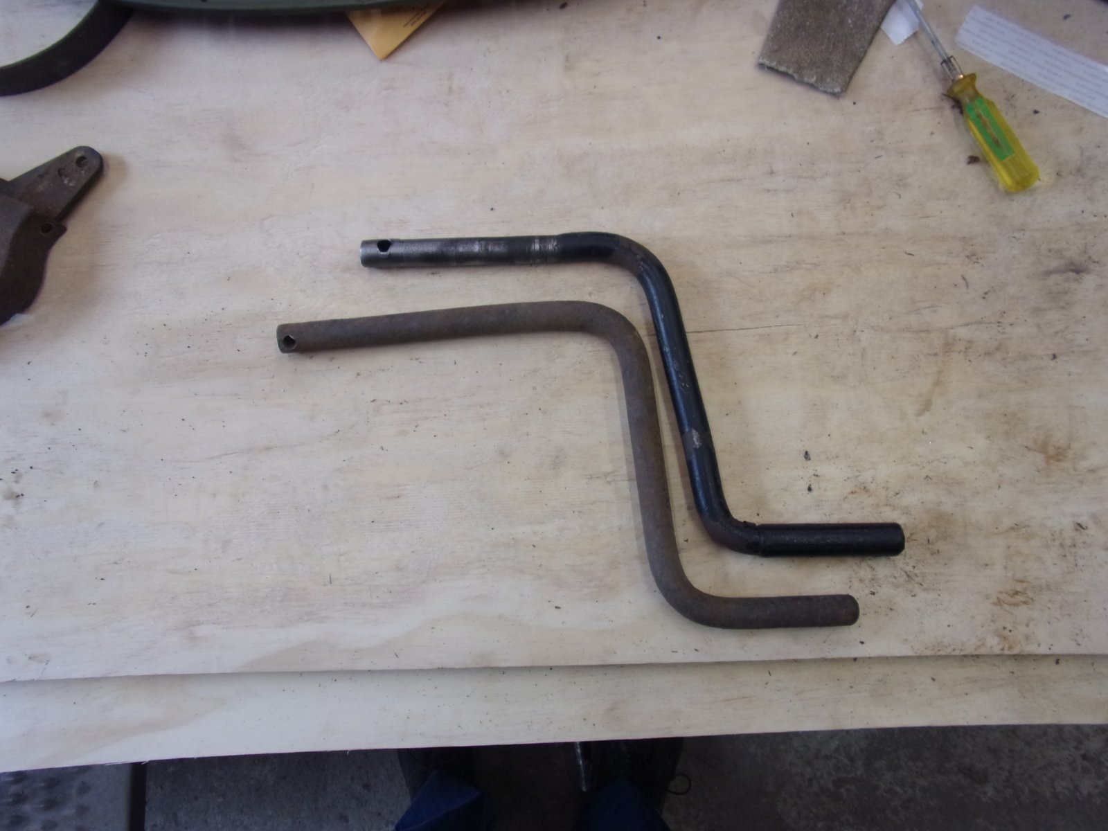

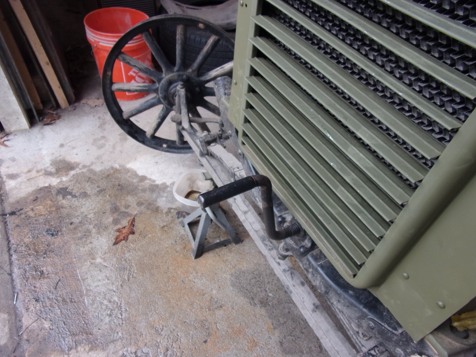

After action report, as promised. Put the crank on the pipe bender and opened up both bends. Pic is next to original crank. Probably opened up more than we needed to, but after installation, certainly clears the shutter and pops off after start. Perfect solution, no welding, drilling, clocking, etc.
Thanks to all.
