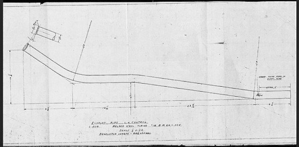

Post by TRDxB2 » Thu Feb 08, 2024 6:52 pm
Think this is it not sure
Ford drawing tail pipe.jpeg (33.71 KiB) Viewed 1916 times
