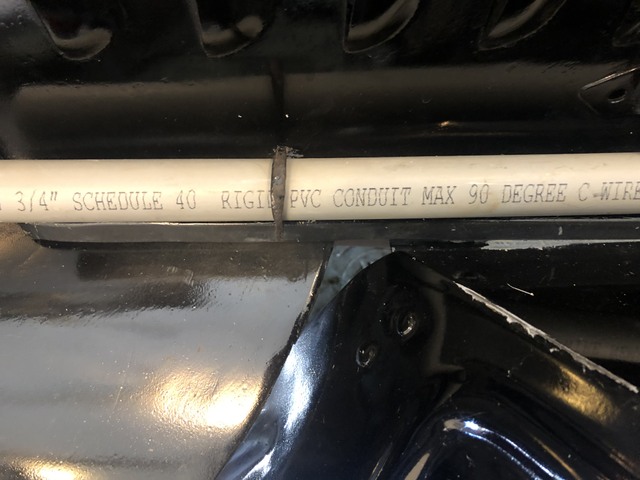

I run a PVC conduit though the hood latches. Its flexible enough to push it in, it's stays where put. Doesn't scratch anything. The hood latches cannot turn. Ford made different latches so find a conduit that's the right diameter. I happened to have some electric conduit that fit.

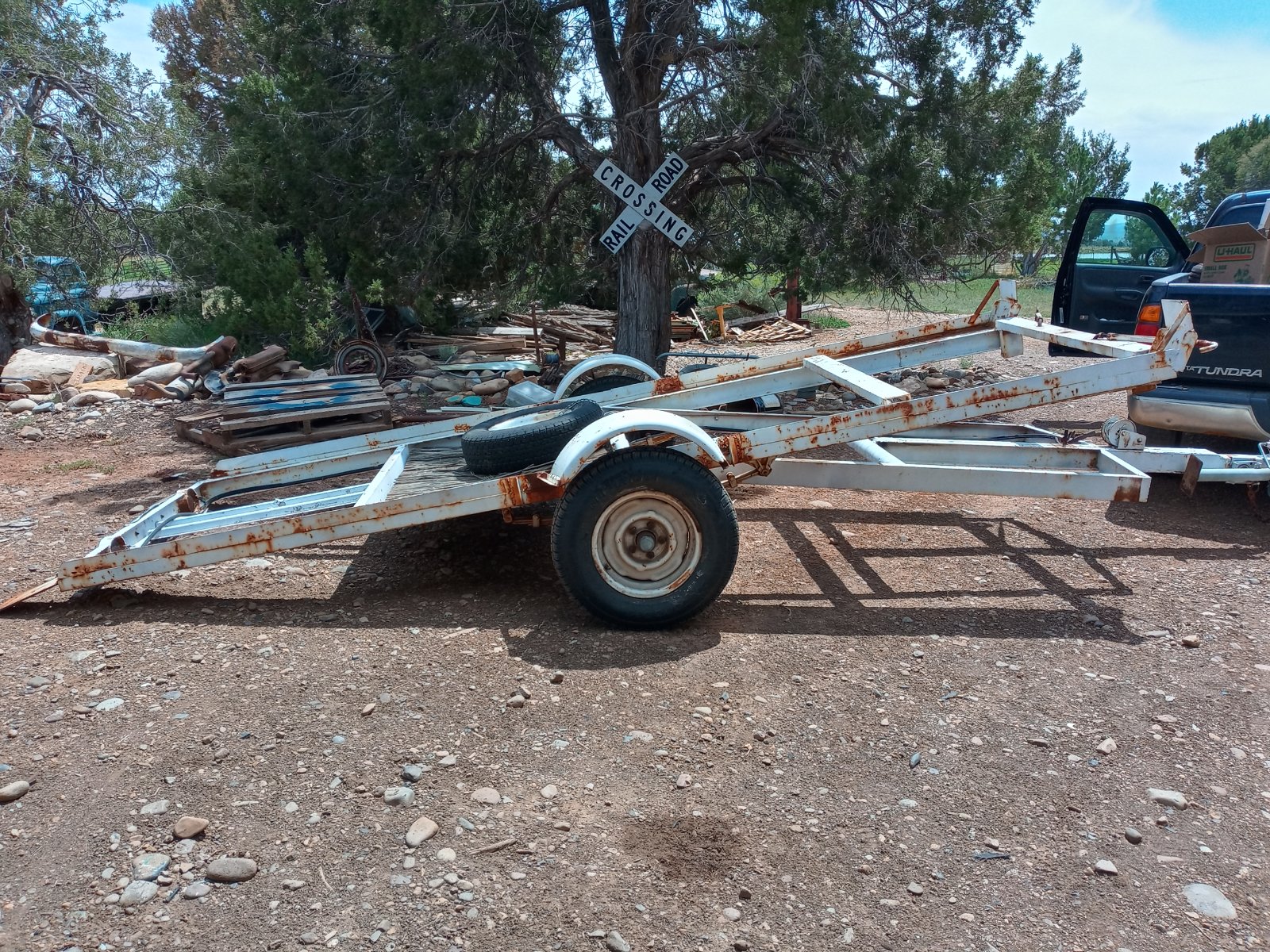

My uncle built this one in the early 70's and passed it along to me. I've run it across the western states twice now, works great! Tandem axles are preferred these days but the lightness and ease of a smaller single axle hauler is appreciated. Because uncle set the balance so well 2 people can easily roll a T up on it. The front has 2 big turnbuckles that hook to the front axle of the car that hold it in place, I use tie downs as well but the T would stay there without them. Of course open trailering does require that you pay attention to any loose items.

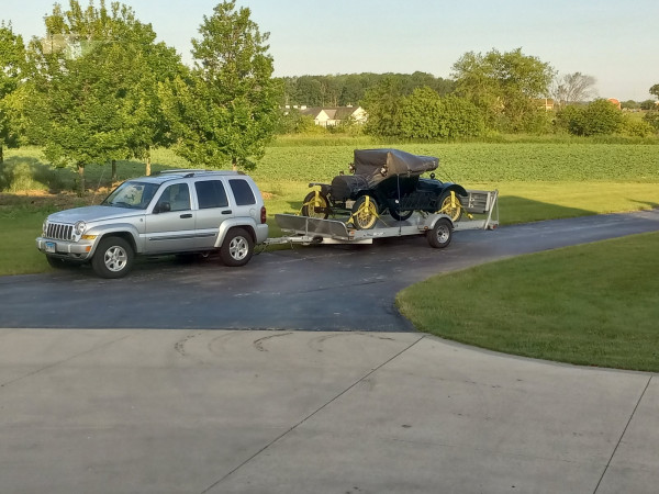

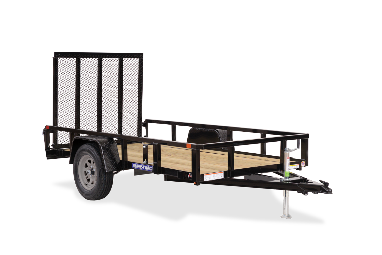

This is a photo of my single axle utility trailer. It is made by Sure-trac if you want to look it up. I think it is 16 foot, and the best part is the full size tires on it. The the rinky dink trailer tires. I put rings in the floor to tie the car down. Nice long ramp with a spring so easy to put up or down.
I have driven it from Milwaukee to Detroit, and to Nebraska. Works great.
I wanted a double axle, but it is too big for me to man handle. It is a tight fit next to the house and my reverse driving skills are about 2 out of 10.
Like Rich I tie my hood down with wide straps like this. I get them at Menards. The orange size is perfect for a hood.

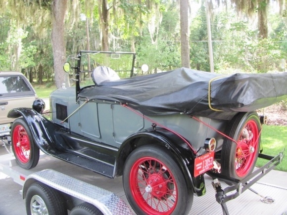

In 2001, I hauled my 1926 coupe on an open U-Haul trailer 1,400 miles from York, Maine to Bartow, Florida with absolutely no problems. I pulled it onto the trailer using a 12v battery operated winch and hauled it behind my F-150 Ford truck and at times, I forgot I was even hauling anything. I highly recommend it. The only worry was when I had to stay overnight in a hotel, I was worried that someone would mess with the car, but you won’t have this worry if you are only hauling locally. Since it was restored in 1972, my T has never been exposed to rain, so I would have worried about rain, but the weather was perfect. Jim Patrick

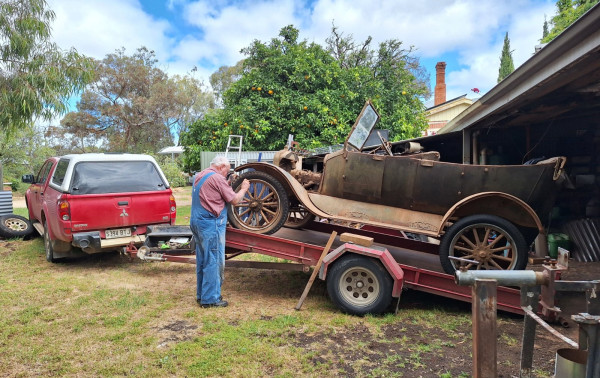

This is the 5th tilting, single axle trailer I hàve
built. At the 2010 National T Rally, all 5 were there!
It has a bed of 6' x 12'
It has a toolbox on the drawbar for the jack and tiedowns, and some spare wheel bearings.
It has a hand winch for breakdowns, but I drive on.
It has electric brakes
It is light and tows excellently at legal highway speeds.
It has a jockey wheel which allows me to push it into tight spaces with ease.
I can even adjust the axle fore and aft for unusual loads, but have never done so.
It has had two blow-outs in 20 years of use, both with loads and without incidents. Allan from down under.

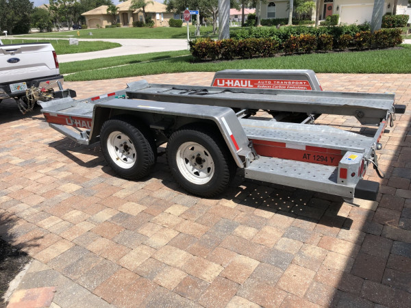

Those U-Haul trailers really are not only nice looking, but sturdy as heck. When my folks wised up and moved to Arizona from Ohio to live out the rest of their golden years, they used one of these behind their 24' U Haul box truck...about 2000 miles, hauling a full sized 1985 Chevy Caprice. Like you said, never knew it was back there. Gotta remember, U-Haul are hauling PROS...so you can bet it's had any "kinks" worked out of it for safety sake. I wonder if Bill could buy one used from U-Haul?jiminbartow wrote: ↑Fri Feb 09, 2024 7:57 pmIn 2001, I hauled my 1926 coupe on an open U-Haul trailer 1,400 miles from York, Maine to Bartow, Florida with absolutely no problems. I pulled it onto the trailer using a 12v battery operated winch and hauled it behind my F-150 Ford truck and at times, I forgot I was even hauling anything. I highly recommend it. The only worry was when I had to stay overnight in a hotel, I was worried that someone would mess with the car, but you won’t have this worry if you are only hauling locally. Since it was restored in 1972, my T has never been exposed to rain, so I would have worried about rain, but the weather was perfect. Jim Patrick

Google “Uhaul sell used trailer “ see what you get.

All timed-out U-Haul trailers are destroyed. If they were sold, you wouldn't rent one.
