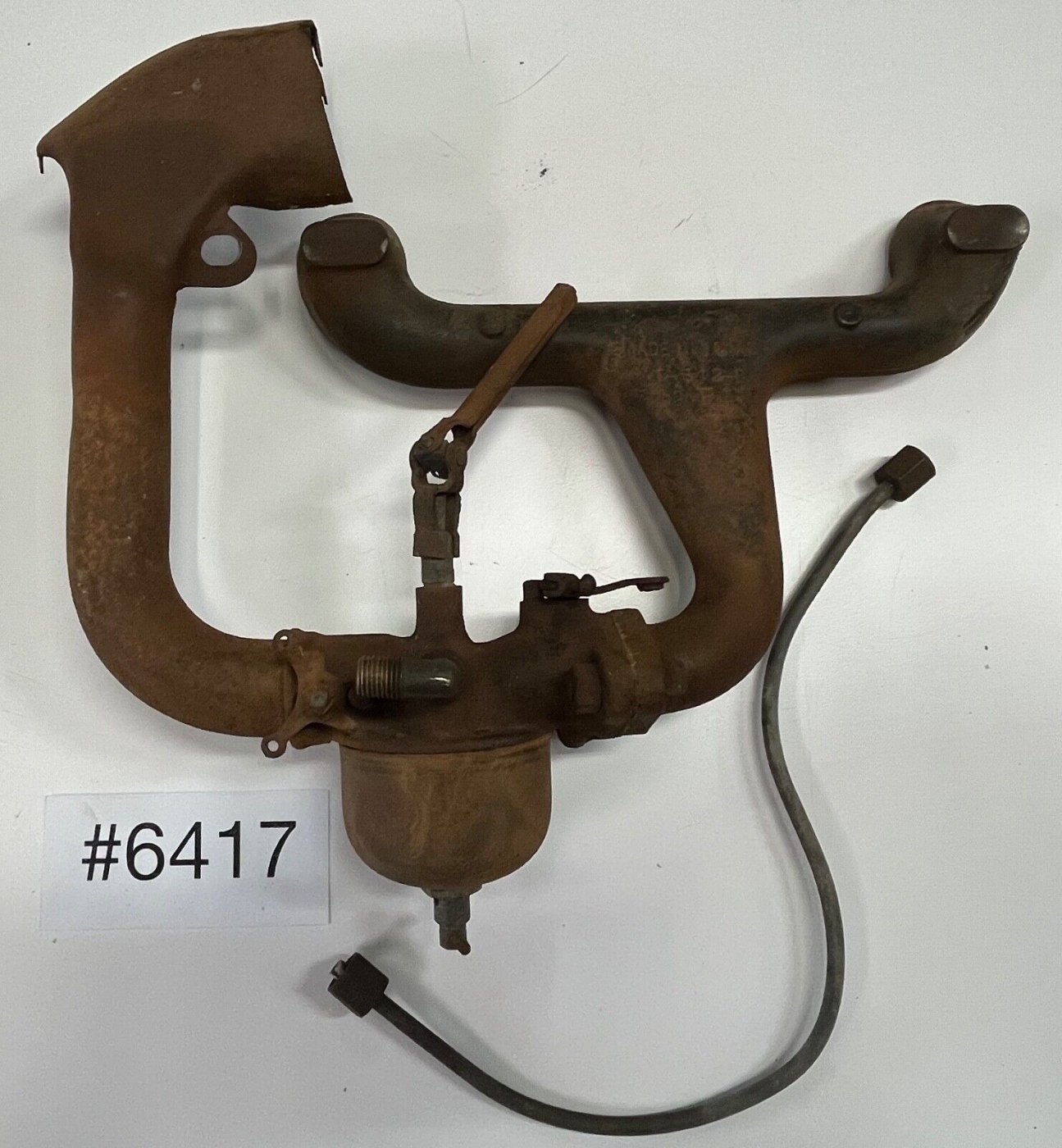

Did you reinstall your Hot Air Pipe for the carburetor? one of previous post showing your new head, the pipe is not present and you might be experiencing icing up in the carburetor.

That popping is an indicator of a lean miss. Try putting the carb stove pipe back on.

Even if you have to wire the heat pipe on, its use will help in your problem diagnostics.

They're called a hot air pipe & if you have the stock combination choke/mixture rod, you'll need the correct one with the indent for the rod to clear.

Got it, thanks. Yeah I was gonna order a repop but Lang's seems to only have the '25 and back one but I need a '26-27

Michael: You've probably checked EBay, here's one listed as fitting thru '27, that appears similar to the Lang's photo but a little spendy in my opinion. Lang's do have many used parts that aren't in the catalog, I suggest a call to see if they might have something that would work.

My '26 coup had standard NH carb and an aftermarket cast aluminum hot air stove, which is irrelevant to your search, but I mention b/c there might be some used aftermarket ones that would suit your needs. Best, jb

Here's what hot air pipe you'll need - notice the flattened are and the manifold clamp connection. I'll check my stash.

Do nothing until you get that heat shield on the carb. I'm obviously with the "It's a fuel problem" guys.

Ok, got a chance to drive it again today, and I definitely solved the overheating problem. No losing power after a long drive. Still has the squeak, which I'm certain is the water pump, I'm going to install zerk fittings because I don't think the grease cups are working especially well. Only issue I had was poor running after a while which was definitely the carburetor icing over. The new hot air tube should fix that, but it hasn't come in the mail yet. I also retorqued the head after the drive, so that is definitely all sorted out now. Aside from needing to change the coolant at some point, it's ready for the road again!

Finally had a beautiful day, and I got the T home from the shop today. Got the new hot air tube on (thanks Steve!) and took it for a longer drive. That hot air pipe definitely made a difference, but I think the carb is still behaving a little weird. Once the engine gets nice and hot I have to turn the knob on the dash to lean out the mix, but when I go to idle, it's definitely running too lean and popping out the exhaust a bit. I haven't gone through the carb totally yet, but what should I check out when I do have it apart? I've done lots of outboard motors, lawnmowers, a few motorcycles, but not one quite like this before
- Posts: 5176
Re: T losing power when hot
Carb fuel level is too low. Re-adjust your float.
