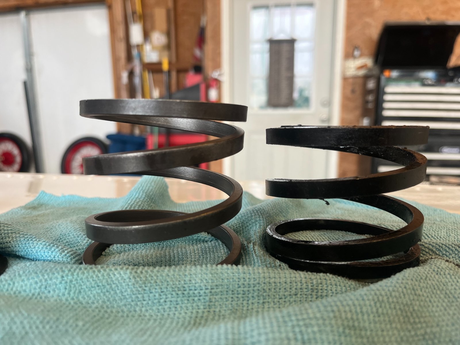

We did manage to get it out and put the new one in. Adjusted all the fingers so the gap was set
to the recommended 13/16". I have attached a photo of new and old. The overall length of the old one
was down to 2.5 inches. I am sure it is probably the original spring. You can see the difference in old and new.
We had some crazy vibrations around 30 mph so kept it under that prior to the change but I would say now that
the vibration has been reduced about 60% and the car is now drivable at 35+ mph.
Would it have been the clutch plates causing the vibration because of the old spring length?

The test for the spring is to compress it on a scale to 2.00". Should read 90#
However, a spring that is that short is suspicious before the scale test.

The Ford service manual has several paragraphs about replacing the clutch spring with out pulling the engine which are very helpful. But with that said it’s easier to do with the engine out of the car especially when going an engine rebuild.
The two things that sometimes get overlooked when doing an engine rebuild are the clutch spring and the magneto coil ring. The engine block work itself becomes the main thing to do and the rest unintentialy overlooked.
And the clutch spring becomes the center of attention when you get it all back together and find that the engine runs great but the car won’t go like it should!!
