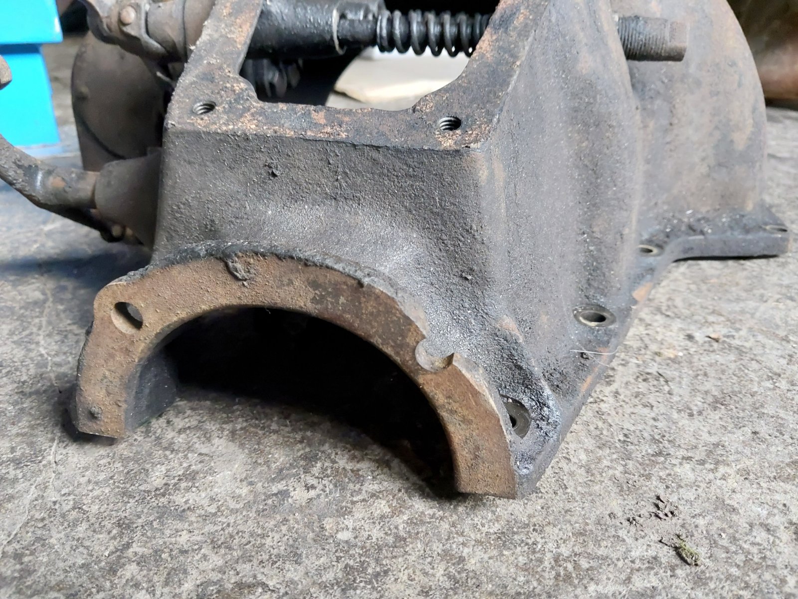

Hello T-people
Can anybody help me further? What material is the hogshead made of? Can it be welded?
I have a hogshead with tight pedal shafts, but unfortunately a corner on the back broke off during the drilling.
Can I fix this?

Looks like an iron starter hogshead. So if you're good at welding cast iron, yes.
Posts: 4410
Re: Can you weld the hogshead?
Post by Wayne Sheldon » Sun Feb 25, 2024 5:41 pm
I am not sure that this is the "best" advice. But my experience has been that the 1920's cast iron hogsheads are a high quality cast iron. They can be welded using some sort of nickel/iron welding rod, or, they can be brazed.
Given that not the entire hole is gone, if it were mine and a better replacement was not readily available? There appears to be enough of the original hole left to provide adequate support for attachment of the ball coupler. I would use some scrap steel, shape a piece to fit in the missing metal, and braze it into place. You would need to be careful of thermal shrinkage which if done all at once could stretch out the arc of the "ball's attaching area". I would braze one side first, then allow to cool before brazing the other side.
I have repaired similar breaks several times myself in that way.

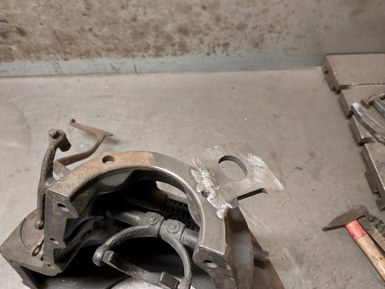

Thanks for all the many answers. I took some time today and did it as Andre described.
I got some cast electrodes, got a piece of cast iron from the scrap metal and slowly welded it on. I made sure it didn't get too warm and always hammered the seam as it cooled down.
The excess material is then sanded off.
I am very happy with the result. How it holds up remains to be seen...

Posts: 4476
Post by Jerry VanOoteghem » Sat Mar 02, 2024 4:25 pm
Looks perfect! Nice job!
Post by Dollisdad » Sat Mar 02, 2024 5:52 pm
Really nice work.
