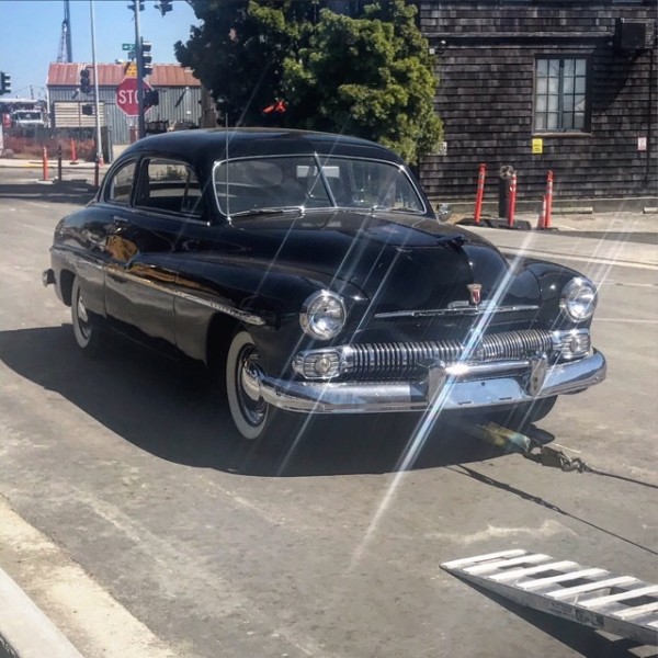

Then today I pick up what was represented by the Seller to be an “ original 1950 Merc “.
Turns out the passenger side has had a lot of body work.
You can see it in the right light ....

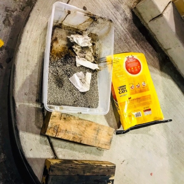

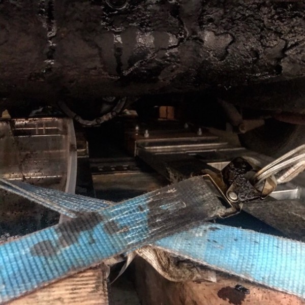

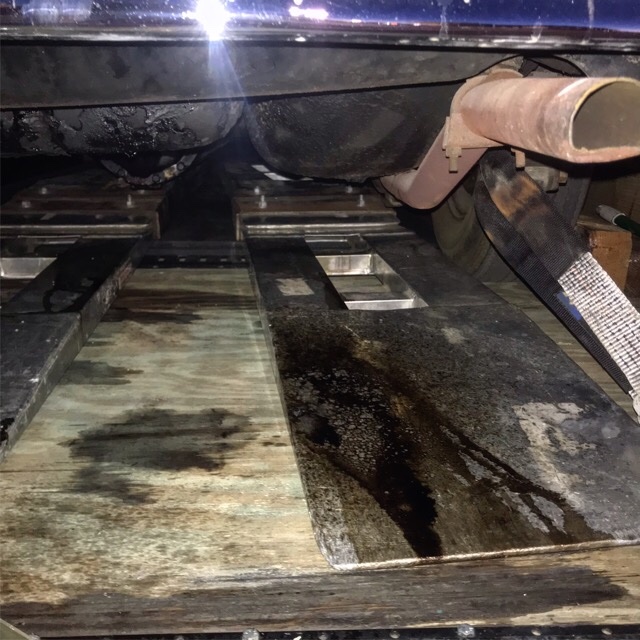

There was what seemed to be a small gas leak
under the gas tank on the ground that noticed before I loaded that the owner explained away as
an overfilled tank ....
So tomorrow I have to have the tank pumped out somewhere - bought a large plastic under bed shoe box
for tonight and filled it with cat litter.
The gas was old varnished gas - going to have to replace that section of trailer floor - the Seller knew d@mn well the gas tank leaked - really sh’tty to not let me know

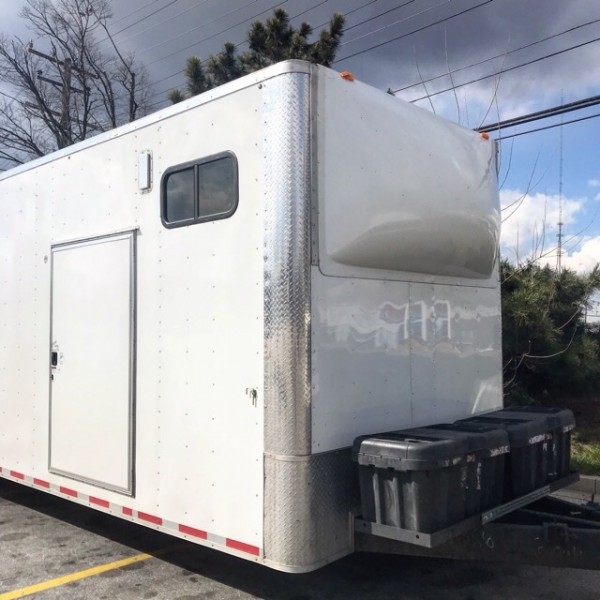

My last two trailers I had sliding screened windows and side vents installed - no roof vents because over time
the mechanism works loose and the plastic dome flies off going down the road.
I usually will run a Model T out of fuel after turning off the fuel supply - I carry a pan and cat litter and place that under the carburetor,
Rubber horse stall mats protect the wood floor.
A lingering gasolne smell might mean gas soaked into wood or some other porous material if you smell it with no car in the trailer.
If it bothers you - it is a valid concern.
Until today it had never bern an issue for me.
