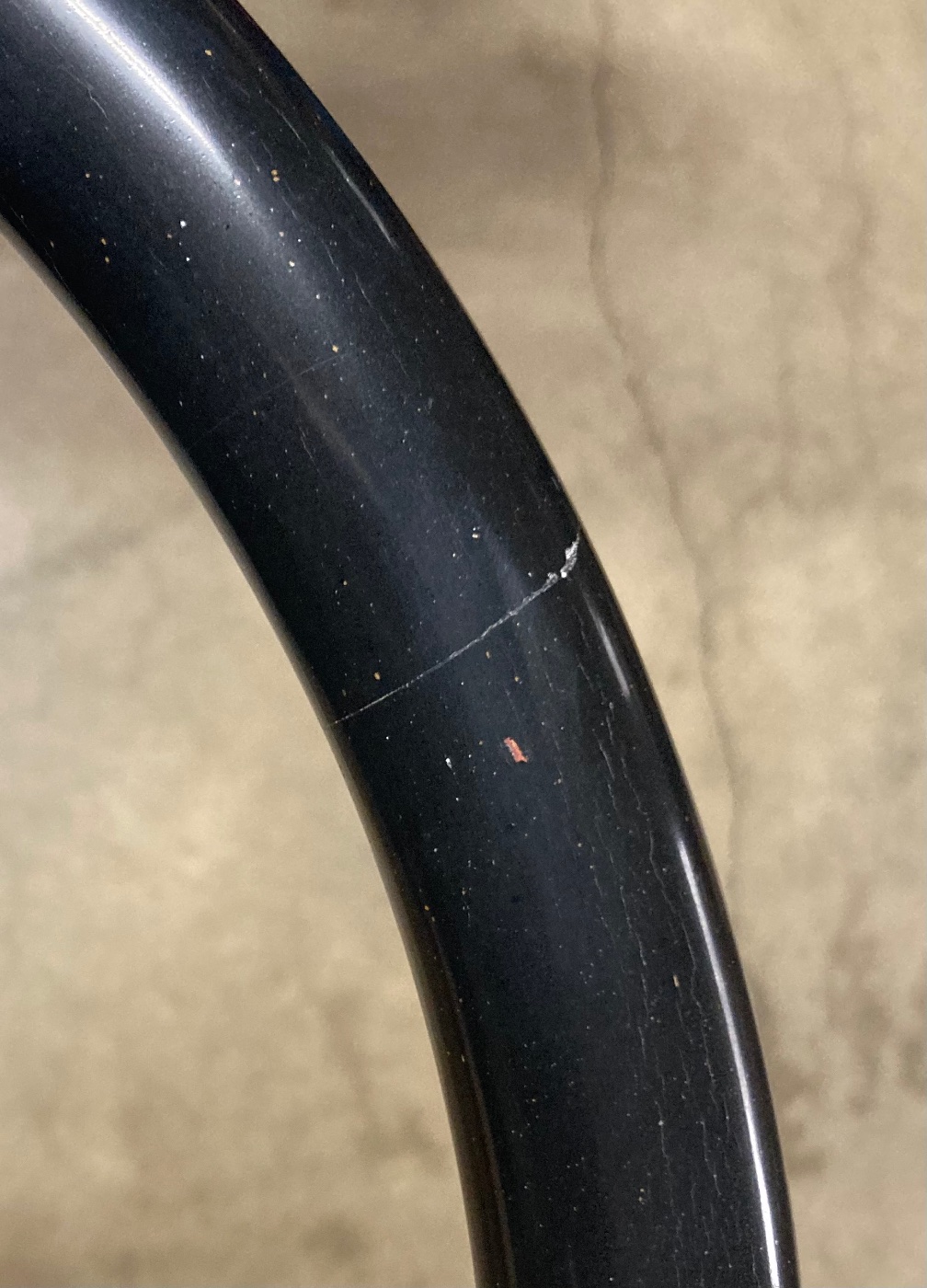

I restore the Fordite steering wheels by sanding and polishing. They always come out great. I recently restored one and had it hanging from the garage door tracks and it fell and broke. It didn’t break in two but split open so it was not a closed circle. I used some JB weld epoxy and clamped it together. It seems as strong as it was before it broke. You can see the crack but it still seems strong and usable.
