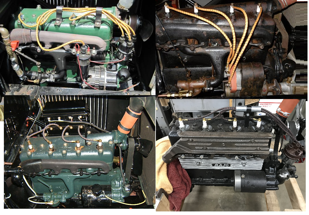

I run a twin spark distributor on my BB RAJO - Zoom - Zoom !

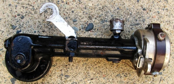

Was wondering why you couldn't put an Etimer in a Timer Elevator
just an example
Speedsters engine looks

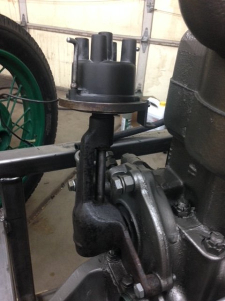

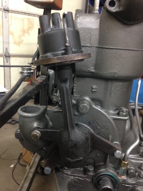

Hi Frank,
Yes that may be the best of both worlds. I would think that using a timer elevator ( designed to use a Ford timer ) would be less work than
redesigning a elevated timer though. The best thing about dizzies, elevated timers & timer elevators is they make it much easier to work on
the ignition.
Craig.
This is a Model T Ranch dizzy mounted on a Atwater-Kent drive. I think this is one of the best & most reliable dizzies out there but like a timer
mounted on the end of the cam is a PITA to work on. I should note that other than lubing the point cam & checking the point gap I have not
done anything to the one on the firetruck for 5 or 6 years.
