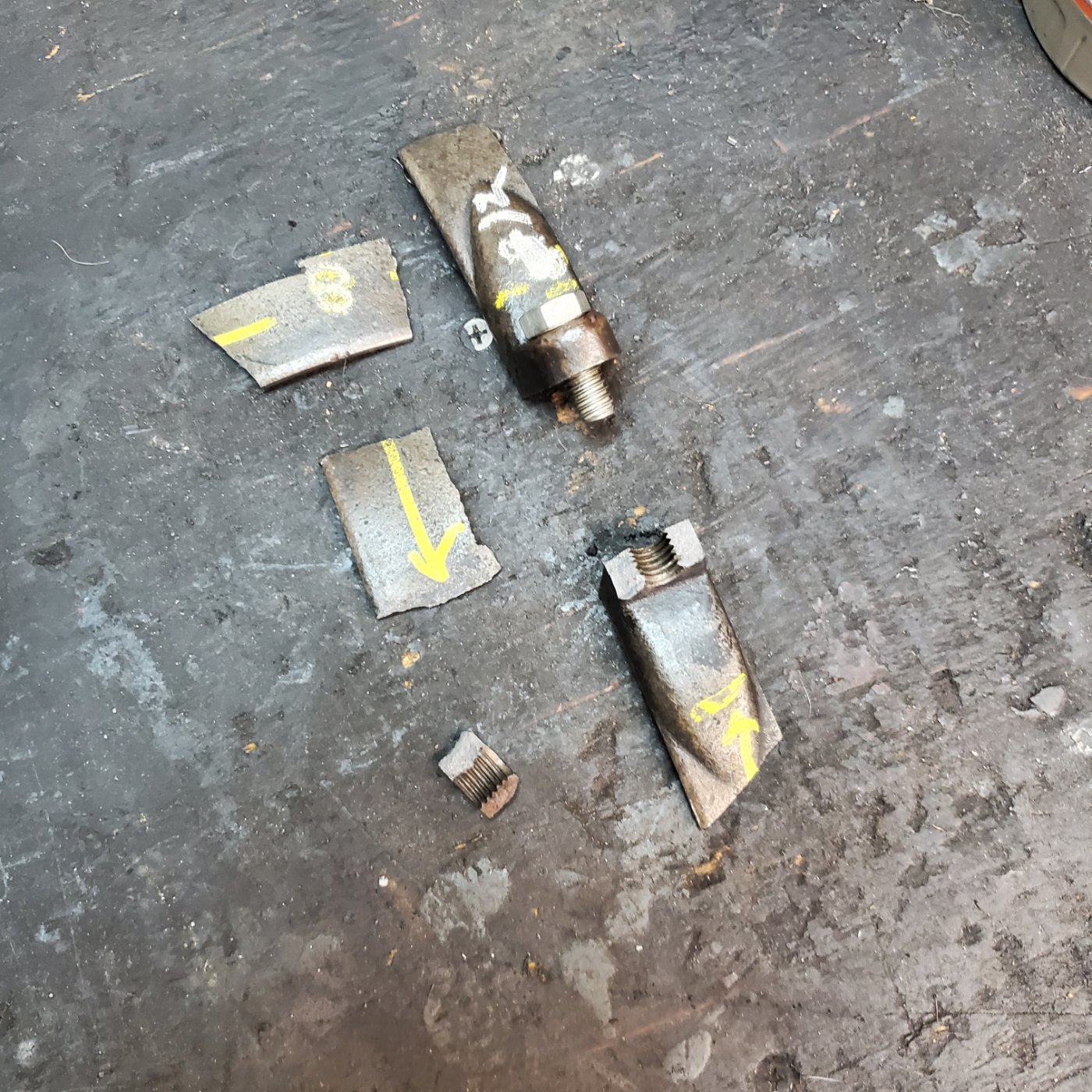

I accidentally dropped my KR Wison transmission jig and broke it. Looking for someone to expertly repair it. Any suggestions?

Perhaps the stitch-n-loc on the larger pieces & weld the smaller pieces but I think the integrity of the mandrel might be compromised. I don't recall if they are cast iron or cast steel - used to be a method to verify by the color of the spark it throws off when hit with a grinder wheel.

#&@%X!!! More like shattered! I wish I knew how to help or what to say. Good luck.

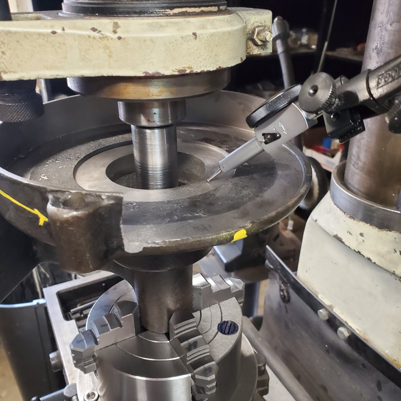

It would be quicker and less stressful to machine the face of the fixture completely off, then make a new “drum” to replace it, attached with screws or even crack pins. The damage to your original is unfortunate, but with some careful machine work could be brought back to life
Here is a 10” x 1-3/4” iron disc that could be easily waterjet into a rough shape to make machining easier
