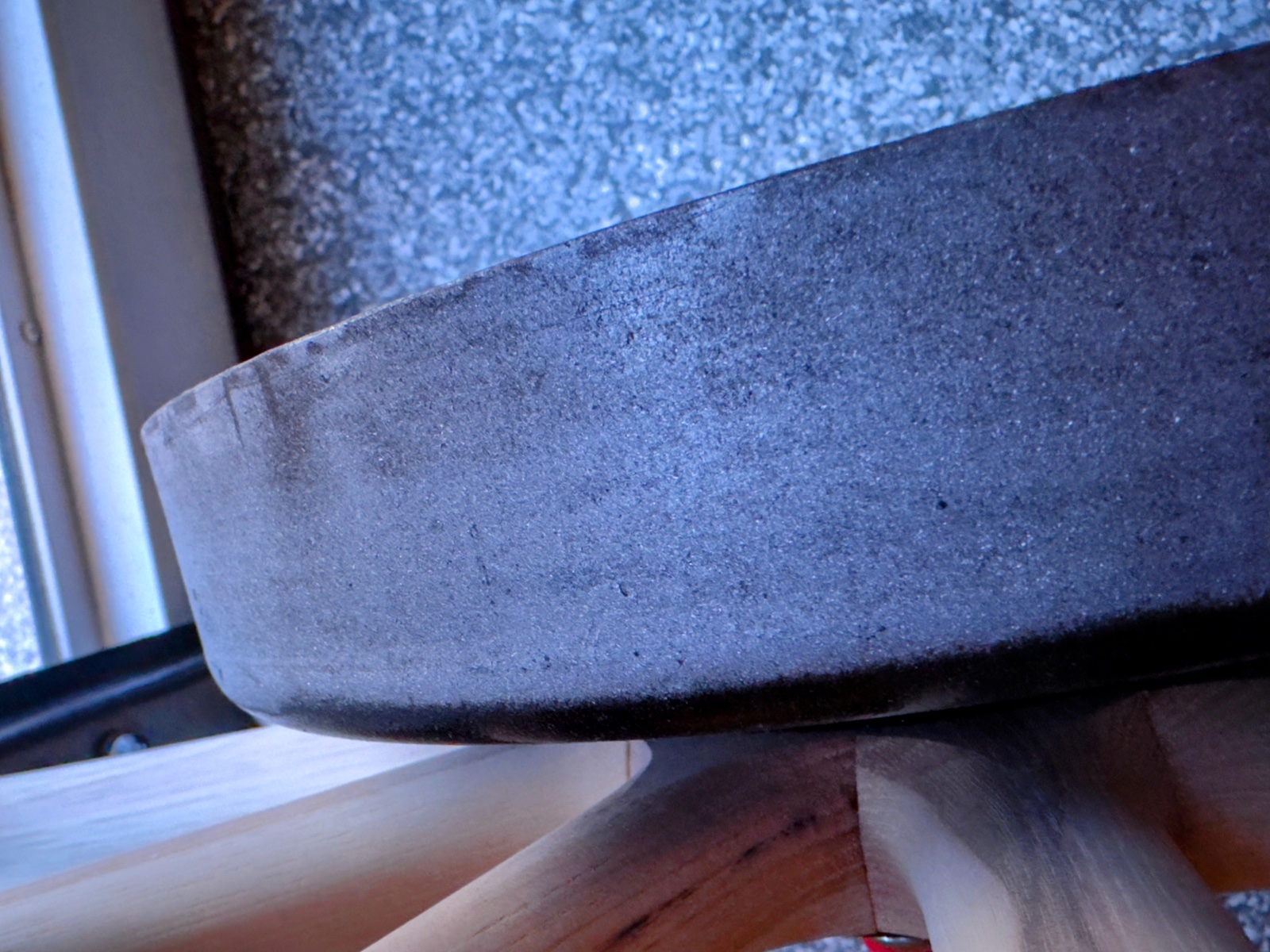

My sandblaster guy went a little aggressive and roughed up the outside of my rear drums. I use Rocky Mountain brakes. Can anyone tell me if that’s going to tear up my brake linings?

Hard to say without a picture. Most likely they can be polished a bit and be okay.

If you are really concerned, the drums could be mounted in a lathe and polished somewhat with fine emery paper.

[image][/image]

I'd dress them down if they were mine.

Re: Rocky mtns and roughed up drums.
Brakes work by turning motion & friction into heat to impede motion. Those may turn motion & friction into dust. I'm of the school that they
need to be smoothed ( not polished ) like trans drums. On the other hand they will darn sure seat in fast.

If you had access to a lathe, or similar way to spin the drums, all you would need to do is to polish the surface with some fine emery paper. They don't need to be a mirror. You just basically want them to feel smooth as you run your hand over them.

Does he really need a lathe? How about jacking up a rear wheel with the brake drum on it, put the car in high gear, and hit it with some emery cloth?

I was going to suggest that too BUT if the R.M.s are mounted, not much room to manipulate the emery cloth !

I don’t think that surface is rough enough to worry about. Probably be smooth in no time.

No. As I mentioned, "If you had access to a lathe, or similar way to spin the drums..."
Your "similar way" suggestion is an excellent one.
I have a lathe, so that's where my mind goes first. Like a carpenter who first reaches for a hammer

When it was stated that the drums were sandblasted, i presumed they were not still on the wheels. That makes them easy to mount in a lathe.
Rough surfaces will tear up lining before the metal surface smooths out. Think about transmission drums.
I've chewed up transmission linings by not filing and sanding smooth after turning on a lathe. I would get the brake drum surfaces as smooth as I could.
A blasted surface isn’t rough enough tear up a brake lining. If anything it would help the lining to conform to the drum faster for better braking.
I agree with Andy. Depending what type of brake lining your using it takes a lot of miles for the lining to wear to get a good mating surface because the band isn't perfectly mated to the drums.
