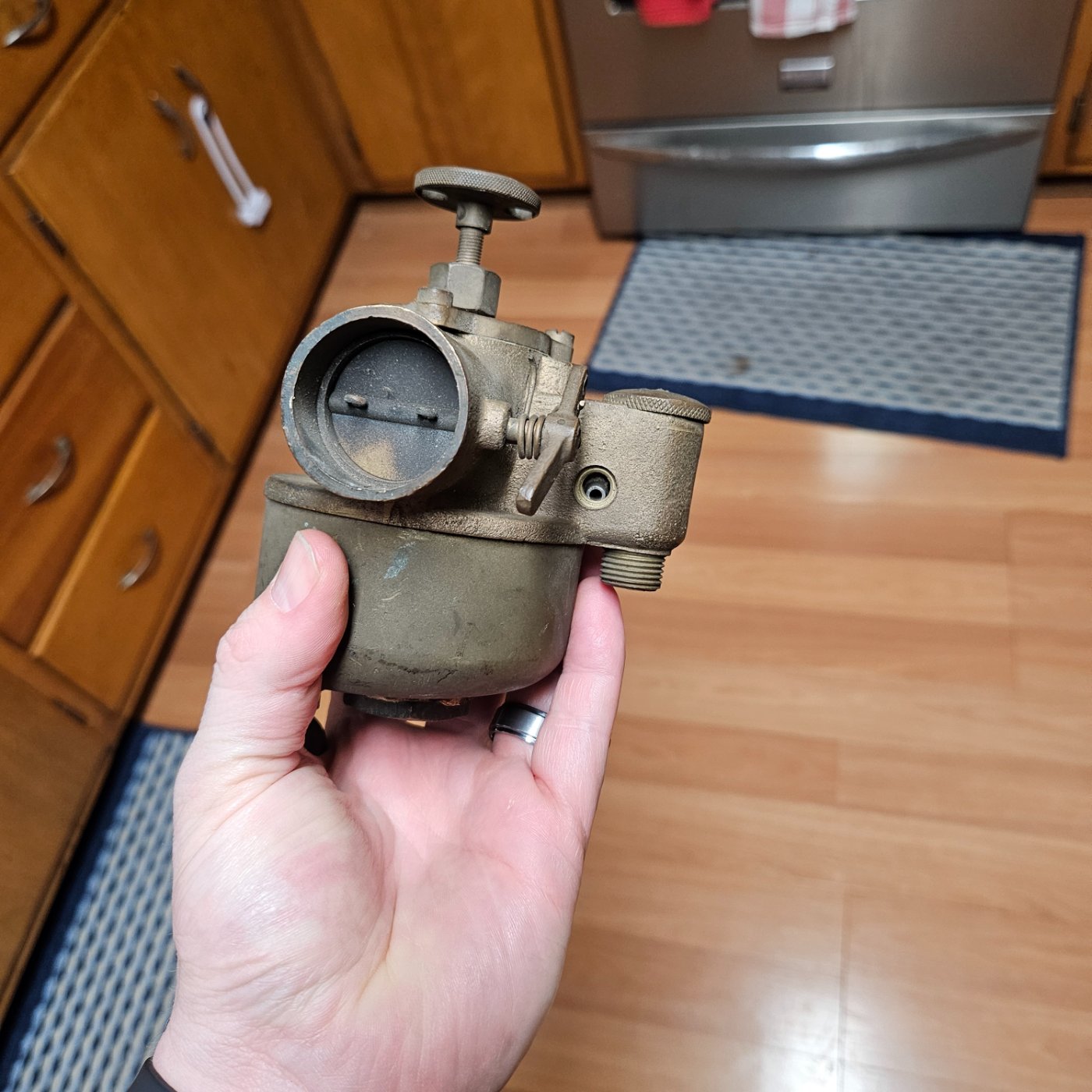

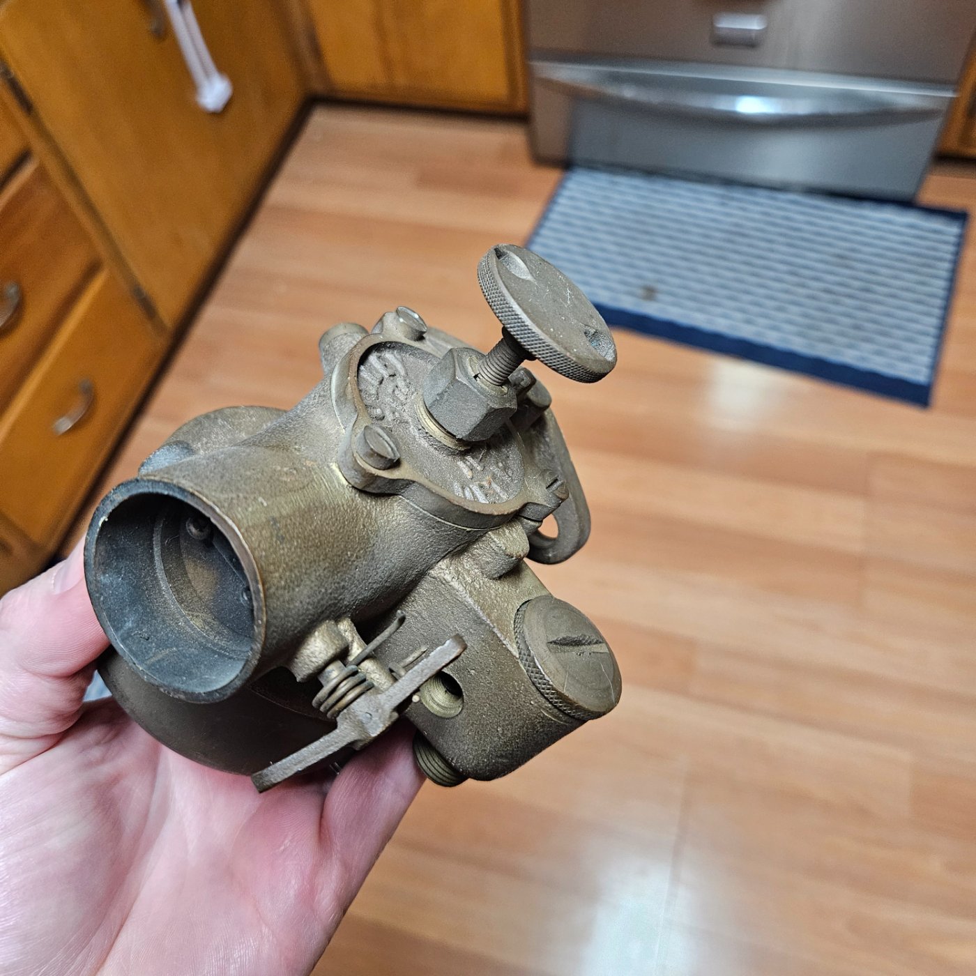

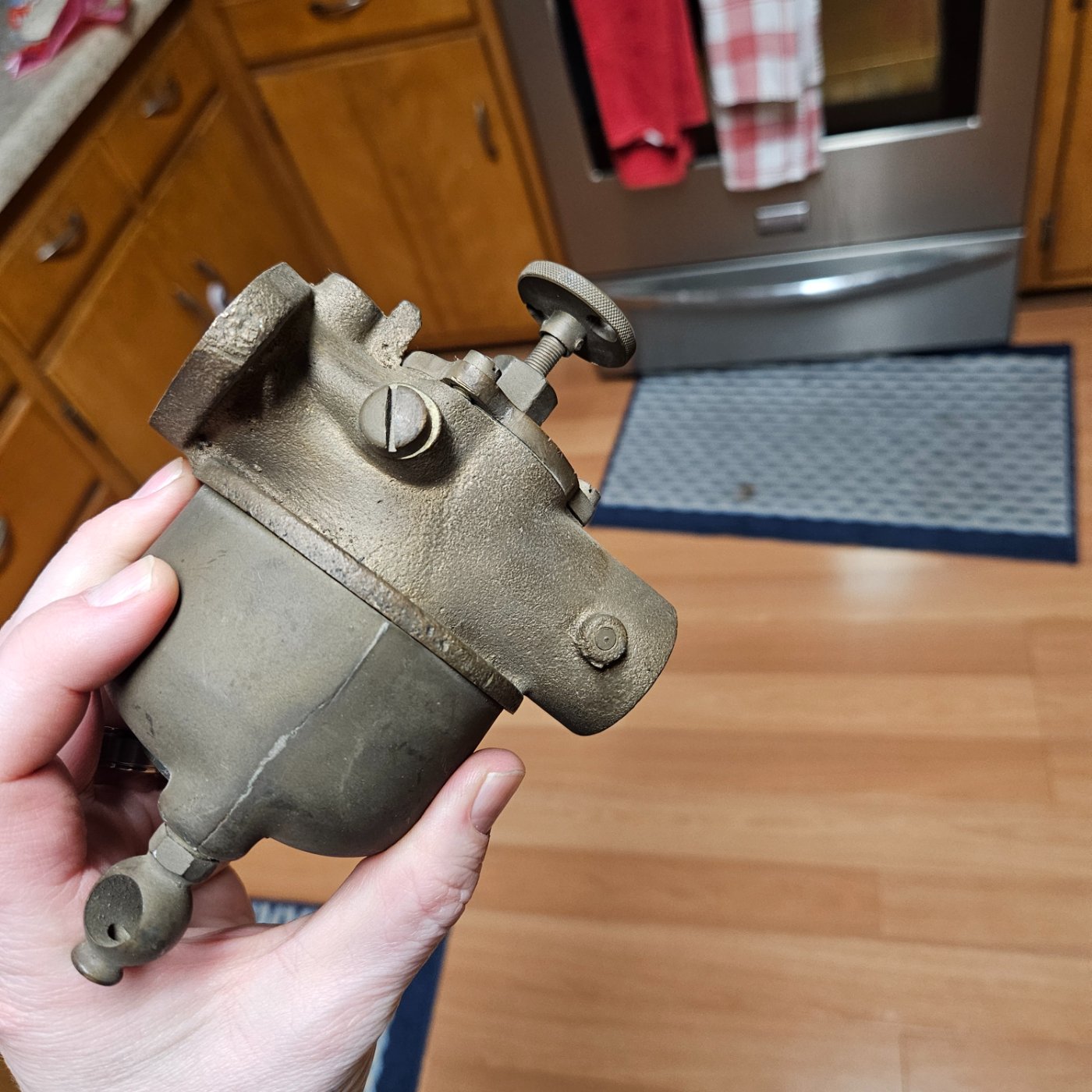

Trying to find info on this brass carb. Top looks like a Holley G, but fuel inlet looks like a Holley H1

1912 style Holley. One of three variations that ford used in 12.

Holley H1, good carb once rebuilt (I suggest Corey Walker). You are missing a very expensive piece and that’s the fuel line pipe that forms the elbow at the male fitting on the bowl. Repairing those bowls,if you can, is a nightmare. Best John

That's a later version of the Holley H1. The earlier one had just two screws on the top plate. This 3 screw version suffered less distortion and made the carbs easier to restore. I too need the stepped screw on which the float arm pivoted.
