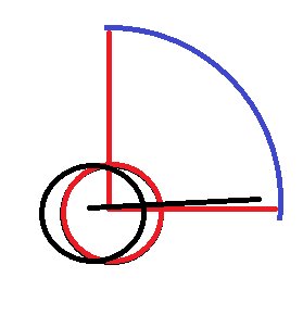

In looking at the video it is apparent to me that as the wishbone is traveling on an arc, piviting counterclockwise up and towards the front, as you jack it up and as the axle moves towards the rear.

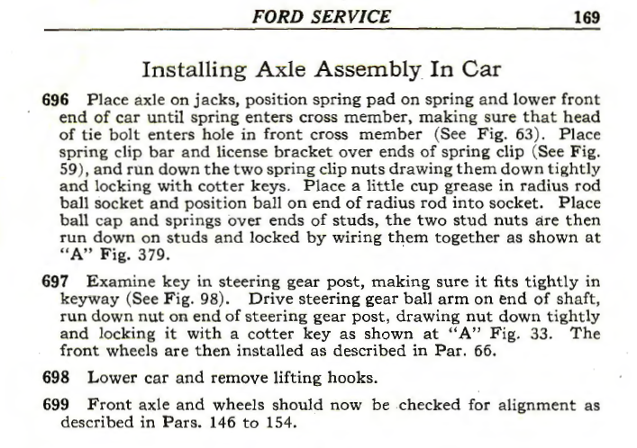

The Service manual procedure has the car lifted off the axle when it was removed & then lowered on onto the axle that is on jacks. That puts load on the spring since the axle is still on jacks

Your words in the video pretty much say it all, "... without any weight on the suspension..." If the spring weren't arched so high, your wishbone ball would drop into place. Let the car's weight rest on the suspension.

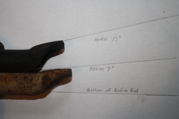

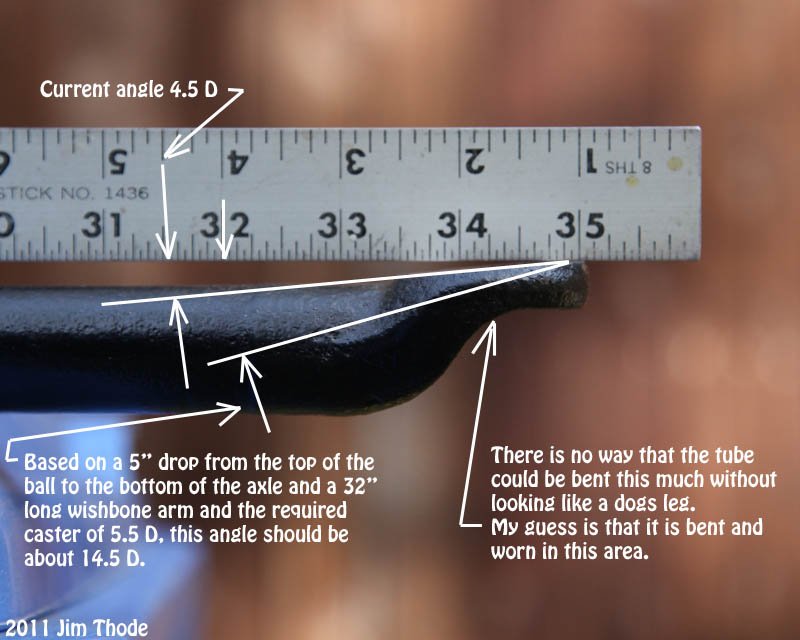

Almost...the photos you quoted and the posts they came from, refer to differences in 1918-25 vs. 1926-27, which all had the wishbone attaching under the axle.
In those prior discussions, users commented on observed differences in radius rods they had laying around, and difficulty getting the alignment on a 26-27 car to the Ford specified -5.5 degree caster.
This has led some to speculate that Ford produced radius rods with different configuration for 26-27, even though the parts books and research all indicates nothing officially changed from 1918 thru 1927.
