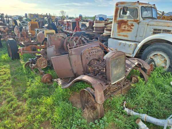

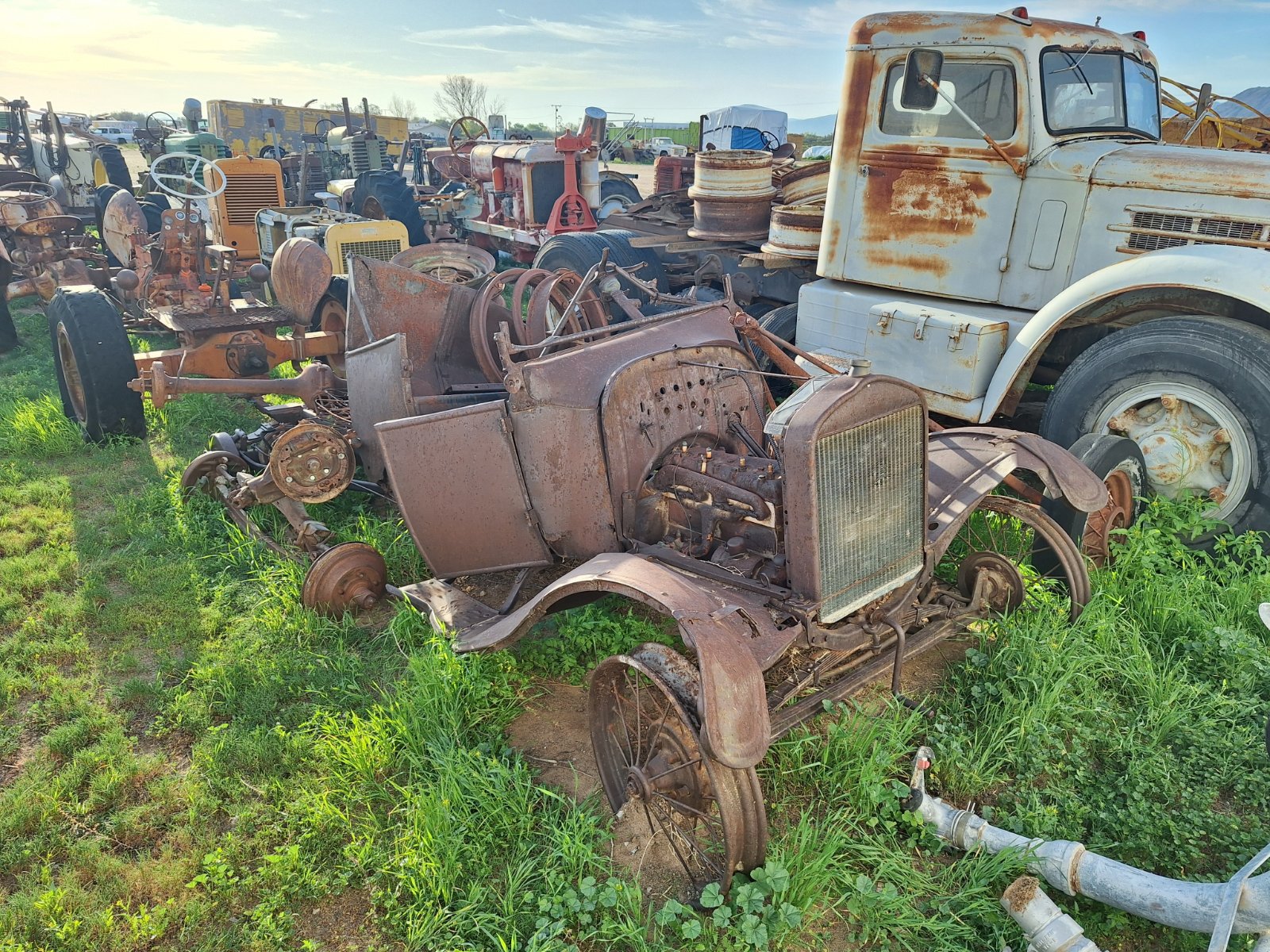

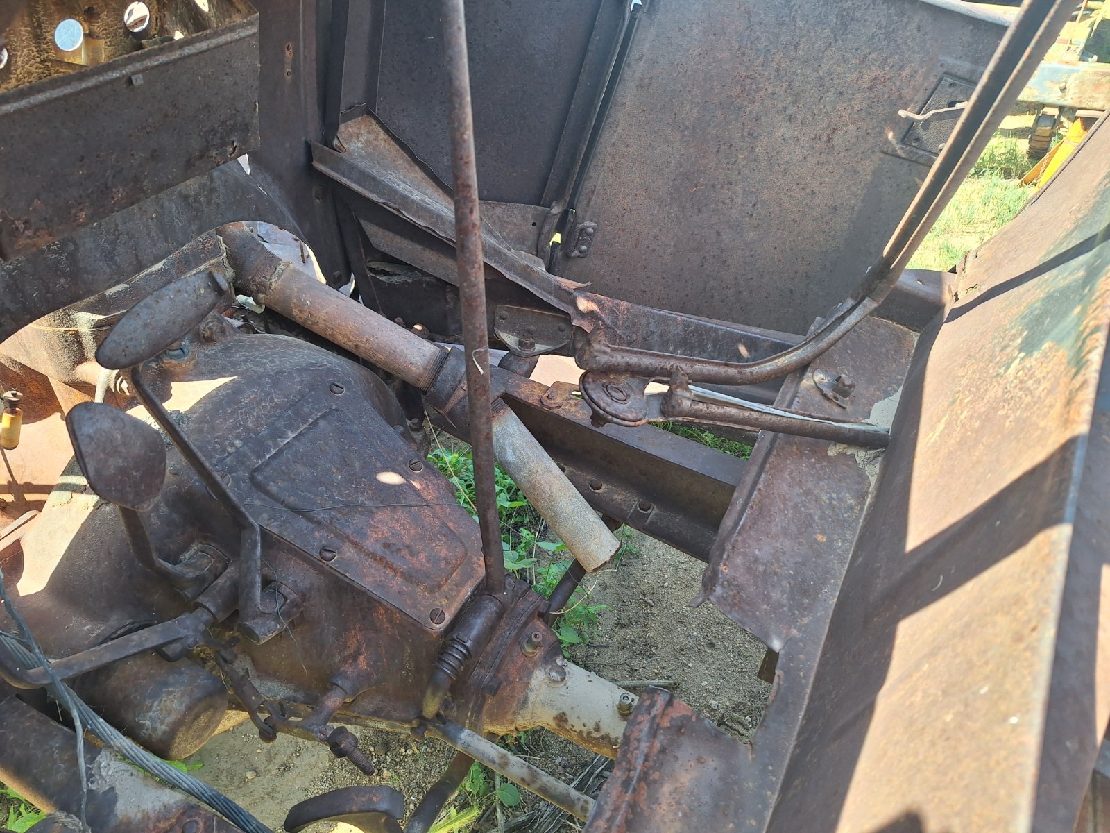

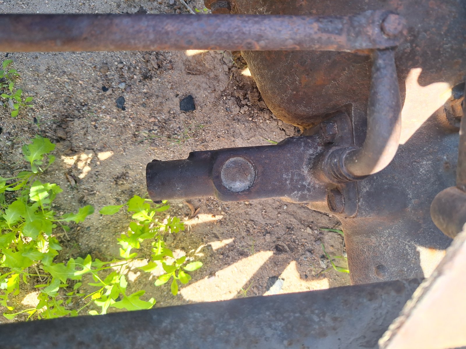

Hello all! I have this 1926? model TT dump truck (I do have the bed for it as well) that was in a fire in the late 50s and has been parked since then. It's on my list of maybe someday projects, and surprisingly the engine is not siezed even after sitting outside since it burned. I was looking it over as I tend to do every now and then, and I noticed a handle on the rear of the transmission that heads to the differential. I know the trucks have a worm drive differential which appears to be what this truck has, so is this for a differential lock, or is it a 2-speed differential? My second question is in regards to the front wheels. I know Ts got wire wheels at the end of production, but I'm not sure when that would have started. Are these the correct wheels for this truck, and would they have been used in unison with the wood spoke rear wheels?

Ruckstell 2 speed axle. Front wheels are '26-'27 Model T wires wheels - get a better photo of the rears. Cab is remnants of a C-Cab.

Were the Ruckstells worm drive? I thought Ruckstells were only in cars, not trucks. All that remains of the rear wheels are the hubs and they were definitely wood spoke. I once saw an old picture of this truck before it burnt, and it had wood spokes on the rear, and was indeed a c-cab. I wish I had the picture now, unfortunately the lady I got the truck from and that had that picture passed away a few years ago.

TT's never (to my knowledge) came from the factory with 26-27 wire wheels; only 21" demountable for 25-27. 30x3 1/2 demountable in front for earlier production. (See MTFCA Model T Encyclopedia for details.

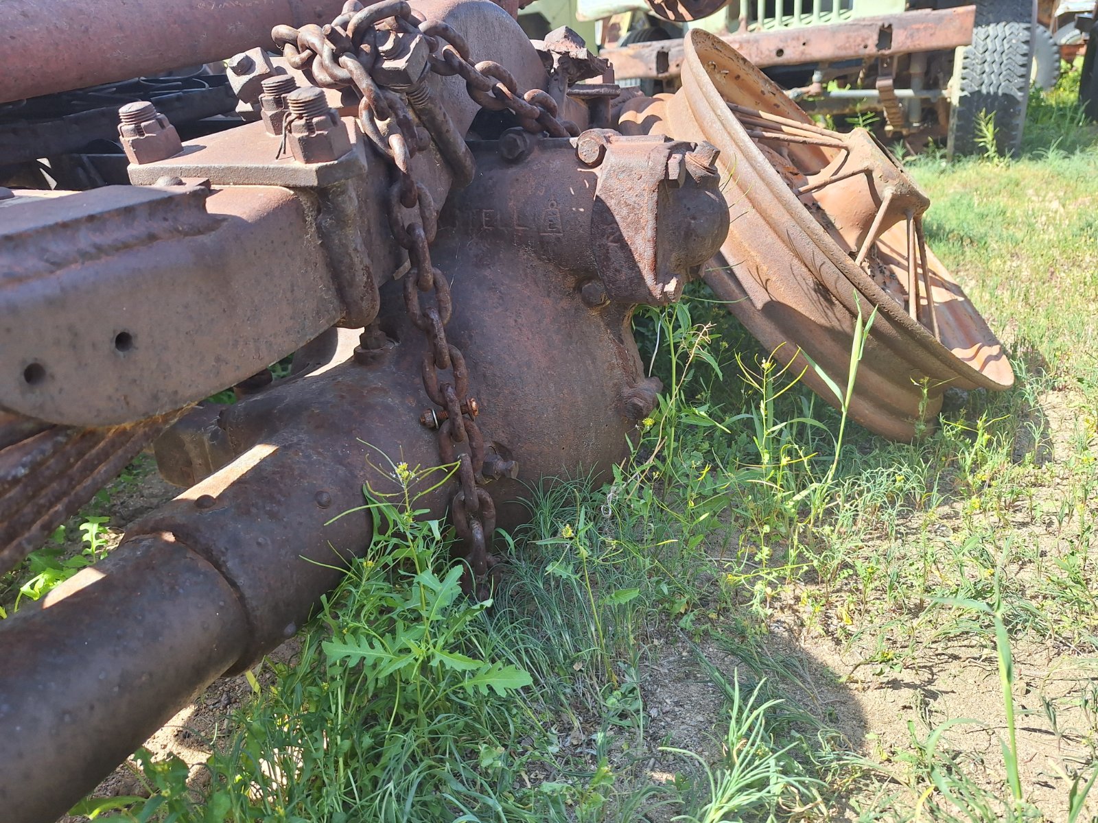

The TT rear is worm drive. The TT Ruckstell uses the standard worm drive as well, with the underdrive gears in the larger diff housing. While they may look at first glance like car Ruckstells they are much beefier and have no interchangeable parts.

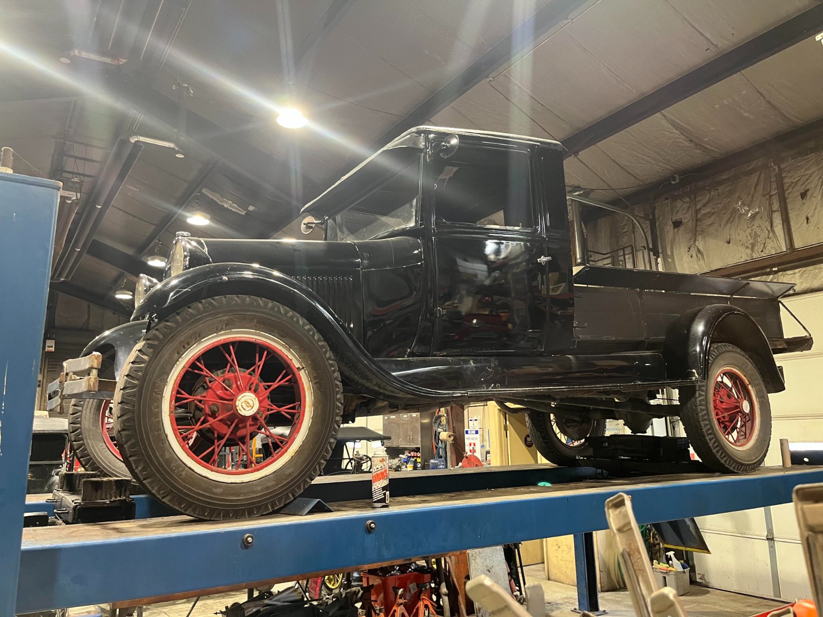

We have a 28 Express at the Village that has wire wheels. It is a really cool truck!

My 26 TT came with a pile of old parts, one being an R axle housing. The guts however, were missing. The outer housing was badly worn from a bad roller, and, being dumb in my twenties I tossed the thing. Ugh...
