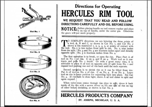

Maybe this’ll help :

Thank you for the tutorial. Reversing the spreader is a valuable lesson. I'll go down this morning and give this a try. I will still split the flap as I believe they are a very tight fit and do not have to be so. Plenty of powder if I have any left from yesterday, although my shop odor has gone from old canvas storage shed to Kids R Us. I'll split it opposite the valve stem hole as I believe the valve stem and rim slip area is the primary source for potential tube damage.

One down and four to go. Slow and steady, steady and slow, that is the way to go. The slit flap and the repositioning of the screw spreader did the trick. Thanks to all who offered input. Painting wooden spoke wheels this weekend and then baby will have a new pair of shoes.

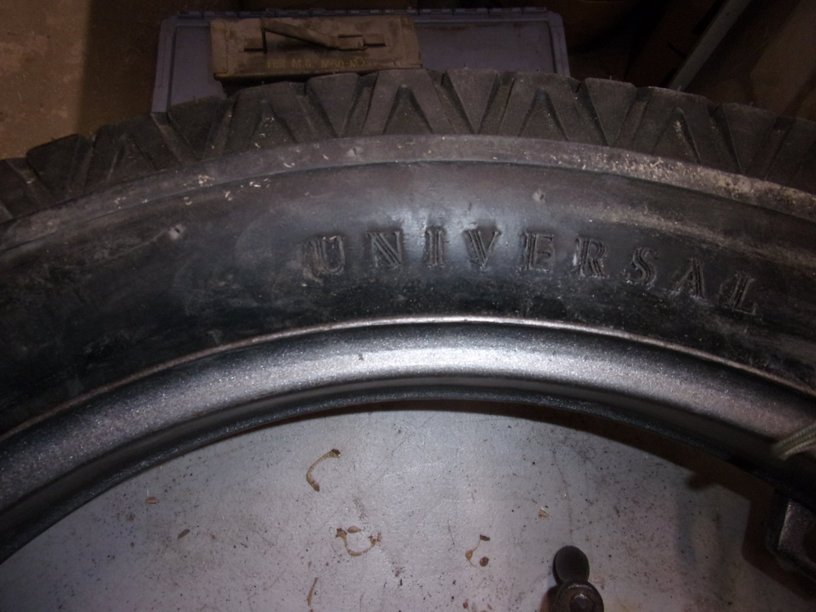

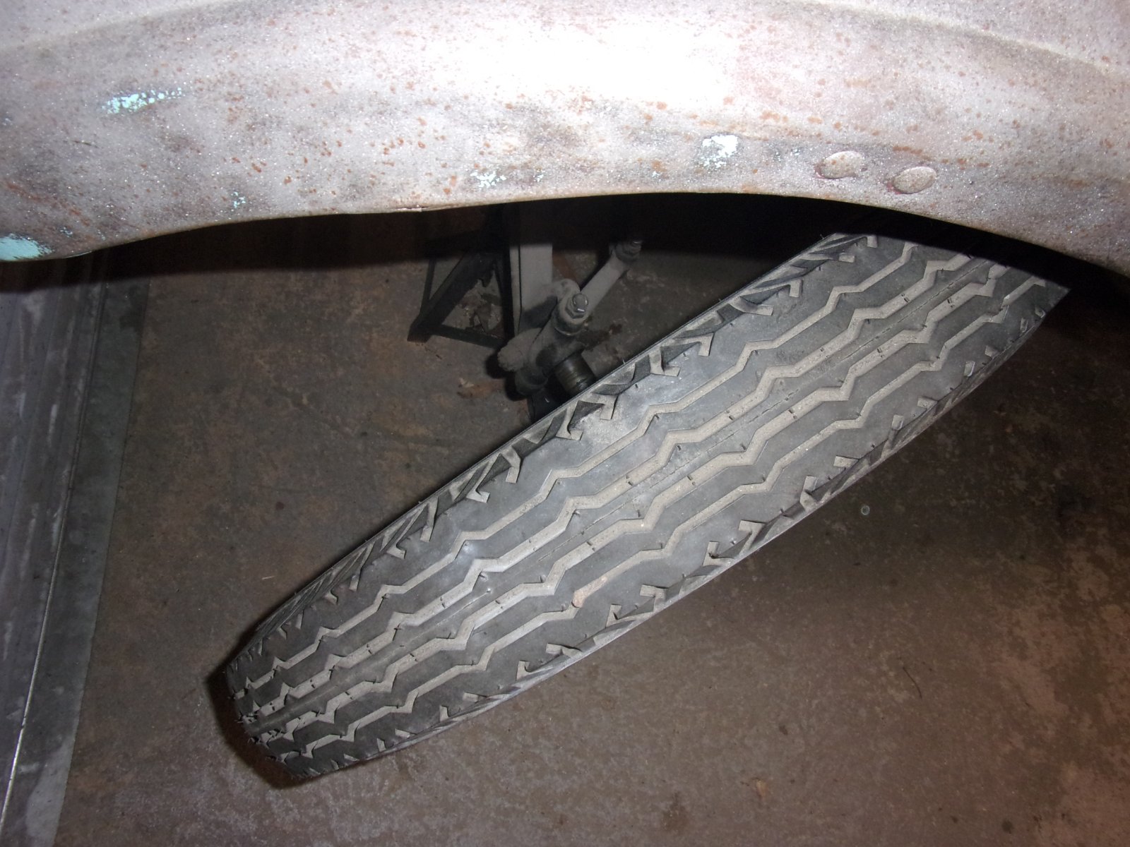

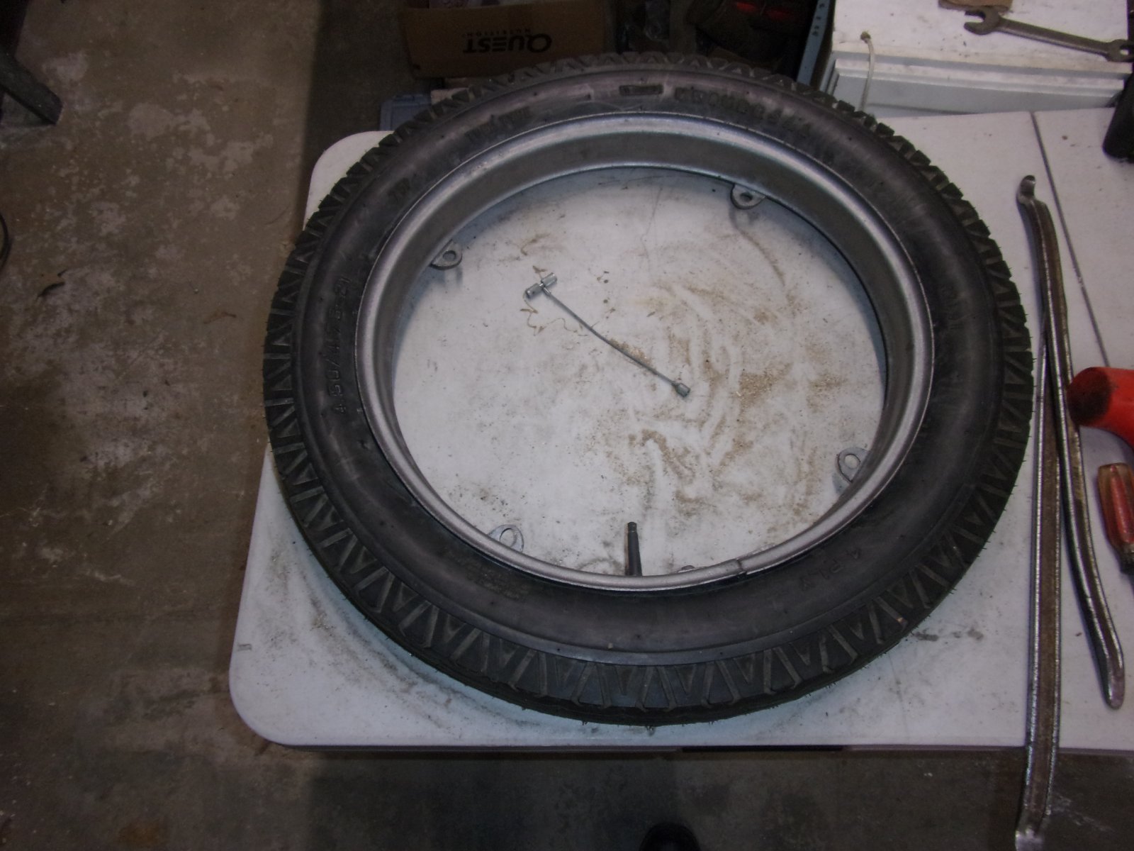

On my previous military Model T, I went with a more aggressive, knobby tread design, but on the ambulance, I went with a more traditional tread design. I've had these on the shelf for a while. Universal tires. Tubes were what came out of the depot hack, all held air and contine to do so.
