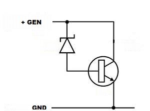

It's not as easy as that because a resistive load is very different to a battery. There's nothing to actually clamp the generator voltage as the output voltage rises - unless the load current is greater than the third brush setting. For the purposes of just running the generator you could use as many headlamp bulbs in parallel as required, to keep the voltage under control. The load would be connected after the cutout so the generator can get itself started on the residual magnetism in the usual way.
A more elegant way would be to load the generator with a very high power zener diode of 7 to 7.5V rated at about 100W. Such devices would be hideously expensive, assuming you could even get one, but a lower power zener with a power transistor is much cheaper and works the same.
