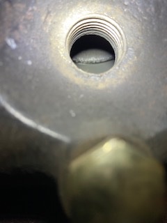

The Buick pistons work great. There’s a little protrusion above the deck.

Post by Brian Cress » Mon Apr 01, 2024 12:49 pm
Thanks for the picture Kenny.
