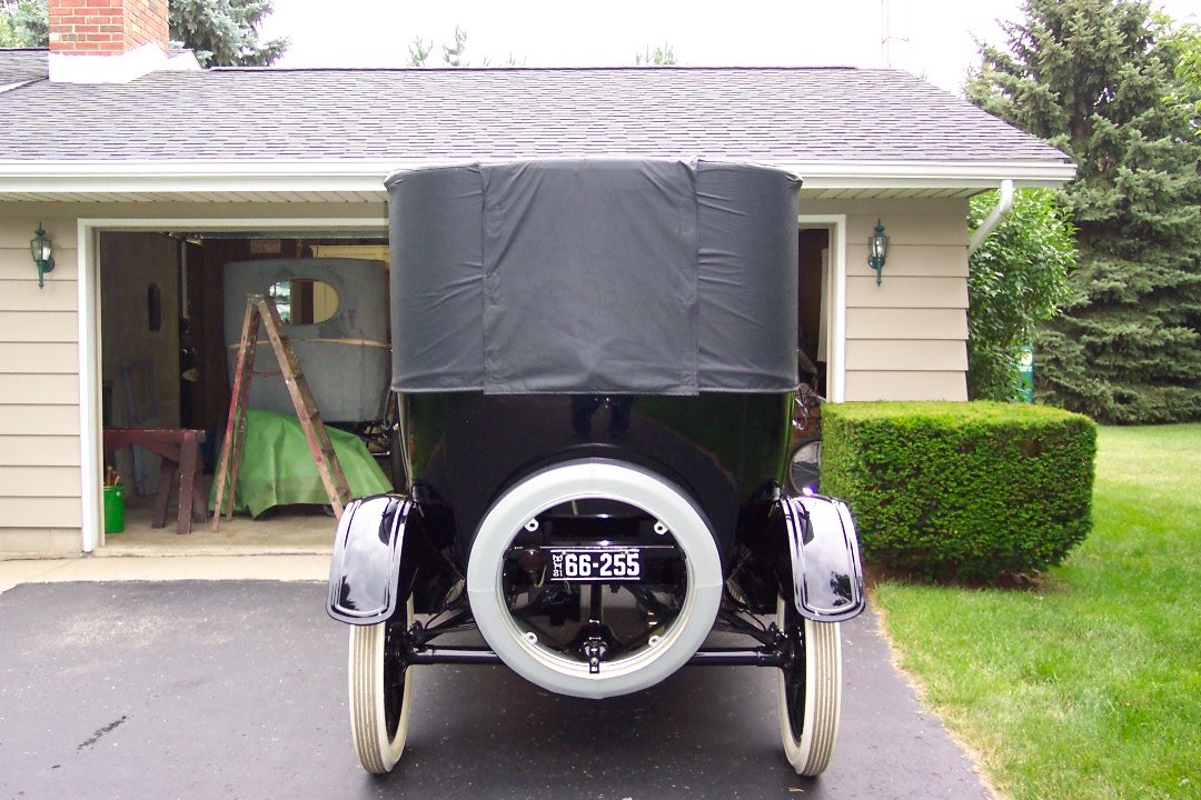

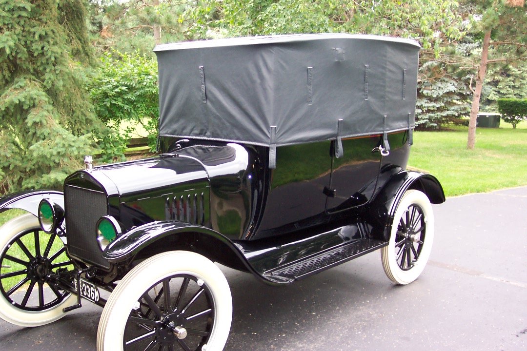

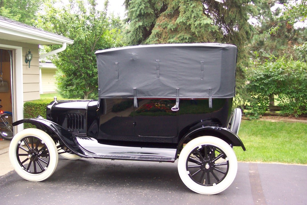

I made this one for my sedan.It fit tightly and held down with elastic straps to the running board. The back has a flap with velcro to ease installation and to pull it snug. Les
