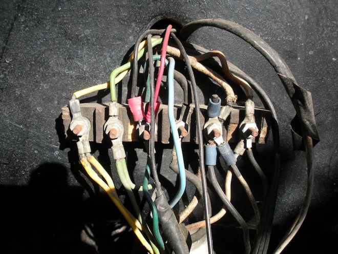

Post by George N Lake Ozark » Sun Jun 02, 2019 5:07 pm
Steve ?? Does your wiring look like what I had inherited ??
Posts: 7395
Re: Why won't my 1923 touring start...
Post by Steve Jelf » Sun Jun 02, 2019 10:32 pm
Something like that. It's wrong for sure. The reproduction wiring harnesses from forty or fifty years ago have the wrong colors, which is not a big deal, but some wrong sized wire, which is.
