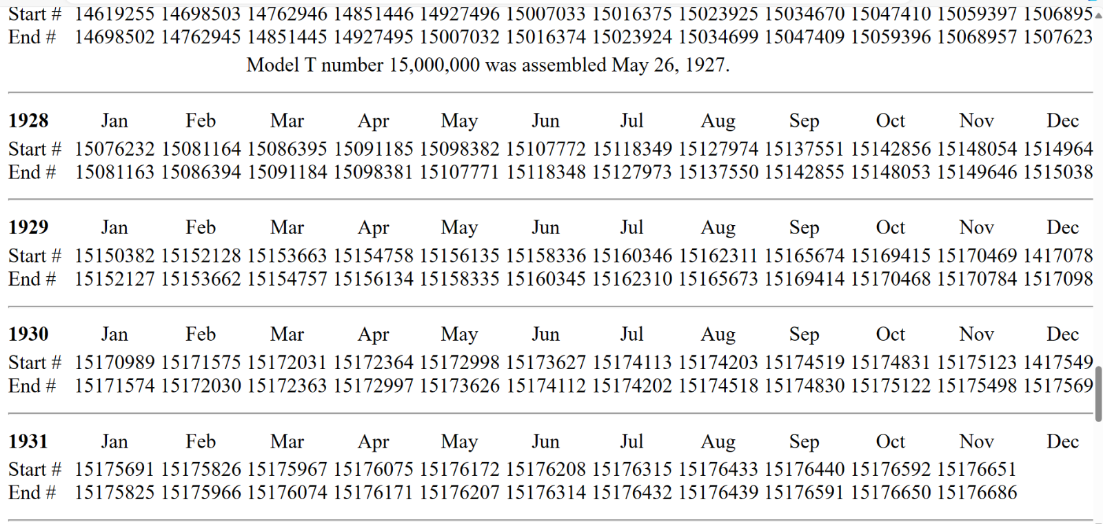

Terry, Your Ford factory numbered August of 1927 block could very well have come in a new TT truck. Ford continued selling some new TT trucks into the fall harvest season in 1927, built from parts on hand at some branch assembly plants.

Post by ModelTWoods » Wed Apr 24, 2024 1:40 pm
kmatt2 wrote:
Wed Apr 24, 2024 3:14 am
Thanks, Matt, I was wondering the same thing, as the numbers are stamped so straight and uniformly as most T engine numbers are.

Post by Kerry » Wed Apr 24, 2024 5:51 pm
Wouldn't they be numbered until the end of production? the last one listed was in 1941 No 15176888
