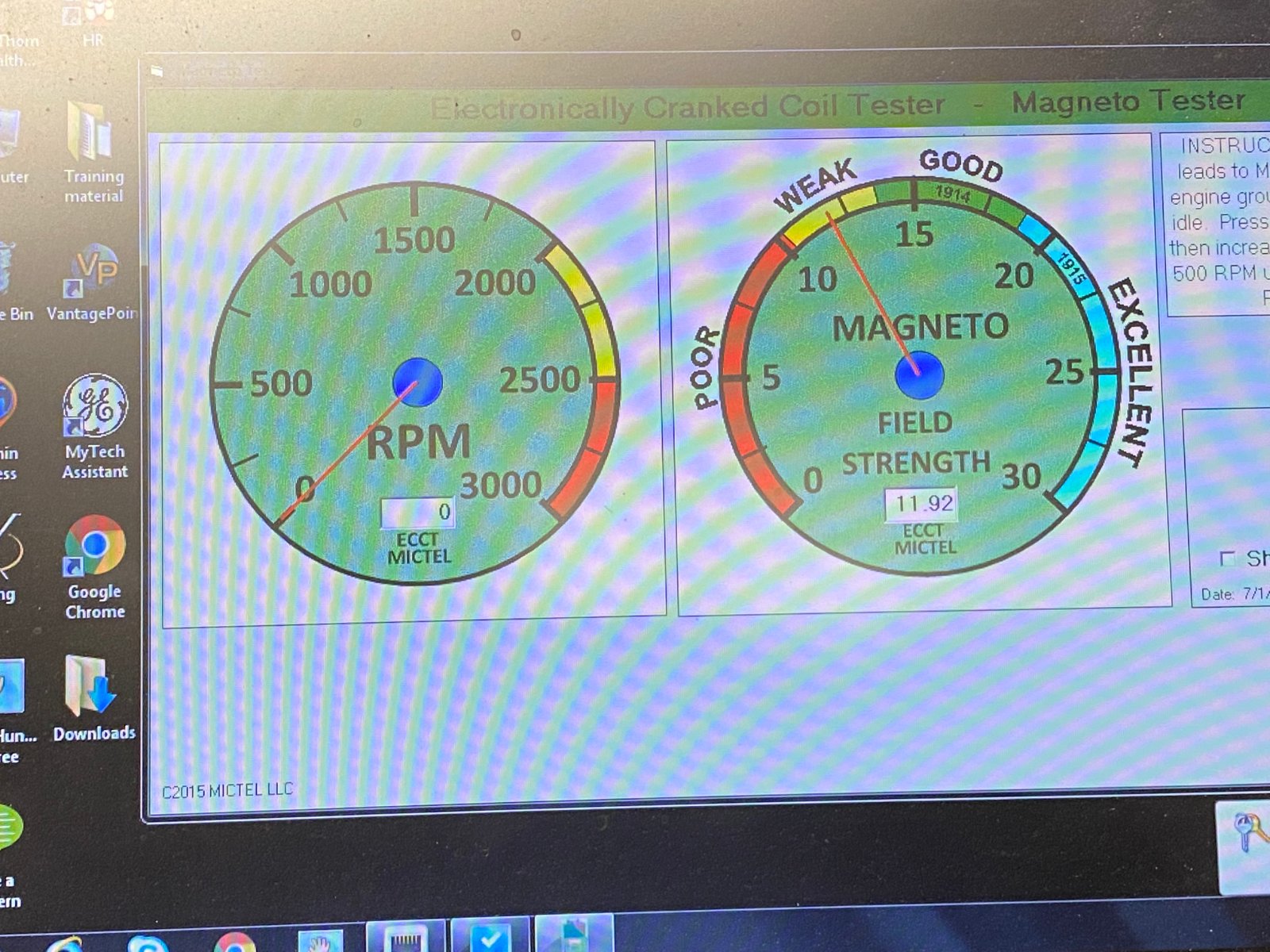

Well, in accordance with the recommended directions provided in the referenced post I attempted an in car magneto refresh with unsuccessful results. I am confident that I did it in accordance with the referenced procedure using 3 12v batteries connected in series. I used stout battery cables and the no load voltage was 38 volts. I very briefly zapped it 8 times and now I have no output on the magneto meter. I did repeat my thrust measurement at .005 inches with a 1' dial mike before and after the procedure with initially the crankshaft pushed back, the wheels chocked and in high gear. Unless someone has another thought, I will run on the 12v battery for this tour season with plans to pull the engine next winter and go after the mag.

Re: 1912 modified for mag to charge a battery
We had a fellow (David Woods) come to one of our club gatherings and demonstrate an in-car charging. It was successful, but did not charge the magnets as much as you would get charging them out of the car. I've attached before and after ECCT readings.
Dave spent quite a bit of time getting the magnets positioned just right before charging. It seemed to me it would be easy to mess up that part.
