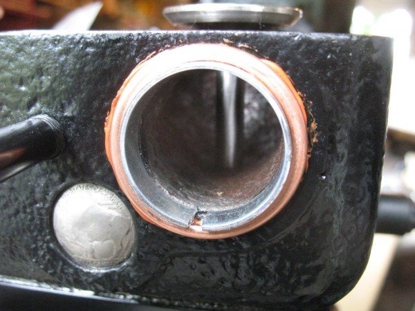

That's my pitted block in the picture.
I used this Permatex product. It's fine. It seals, and when I removed the manifolds after almost three years of driving (including Detroit and back) it was unburned. The label says red, but as the first picture shows it's closer to orange.
